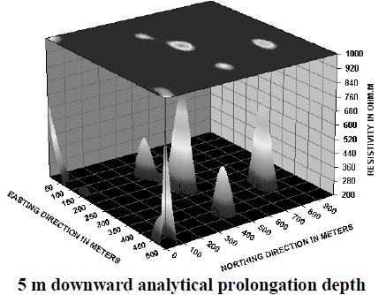

help for building a model
has some one any idea how can I drawing this model
thanks

check the forum (search) there are a few discussions how to use ALE to create a meshed volume from an analytical or piecewise / interpolated f(x,y) function
Hi check the forum (search) there are a few discussions how to use ALE to create a meshed volume from an analytical or piecewise / interpolated f(x,y) function -- Good luck Ivar

but i dont have a Moving Mesh interface or a Deformed Geometry interface.
my geometry represent a layered earth witn inclusions wich have differents resistivities. On surface I assume a number of electrode. In each electrode, I inject current and I want to calculate the potential on the other electrodes.
tanks ivar, but i dont have a Moving Mesh interface or a Deformed Geometry interface. my geometry represent a layered earth witn inclusions wich have differents resistivities. On surface I assume a number of electrode. In each electrode, I inject current and I want to calculate the potential on the other electrodes.

Can I draw it with autocad then export my geometry to comsol?
please help
hye Can I draw it with autocad then export my geometry to comsol? please help

Hi; which form is to be checked. I've been going through the COMSOL Discussion Form and haven't found anything yet.
cheers
Hi; which form is to be checked. I've been going through the COMSOL Discussion Form and haven't found anything yet. cheers [QUOTE] Hi check the forum (search) there are a few discussions how to use ALE to create a meshed volume from an analytical or piecewise / interpolated f(x,y) function -- Good luck Ivar [/QUOTE]

take a look here
www.comsol.eu/community/forums/general/thread/4508/
hope this is what you want
Hi take a look here http://www.comsol.eu/community/forums/general/thread/4508/ hope this is what you want -- Good luck Ivar

Here is a 3D example.
Niklas
Here is a 3D example. Niklas
