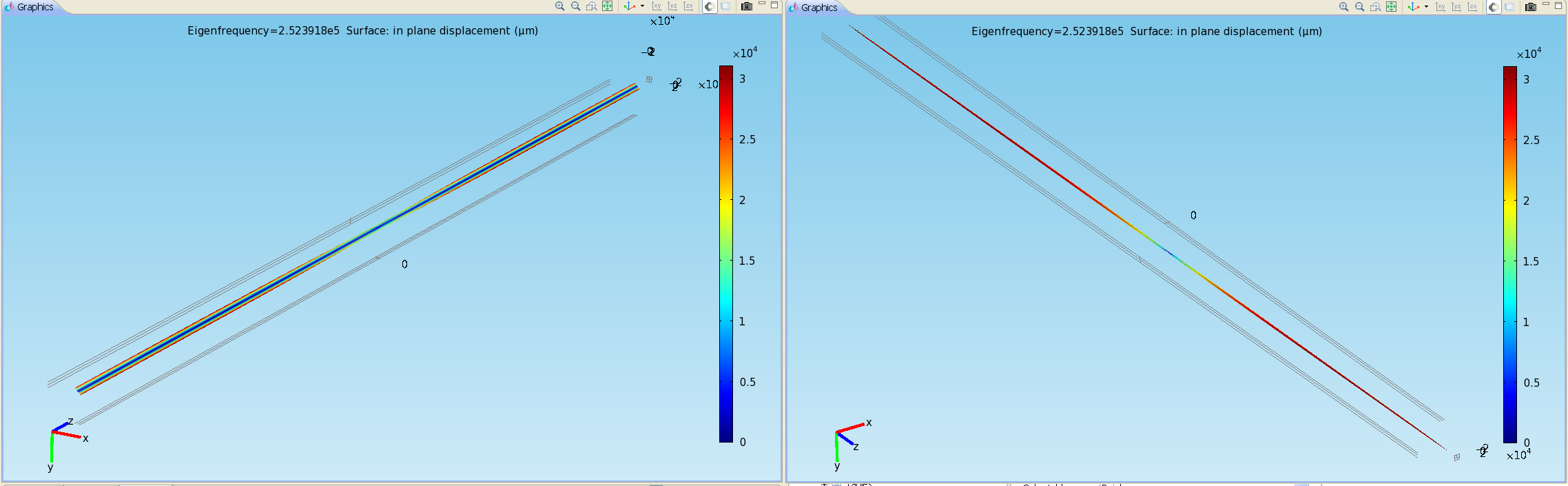

OK. So I finally got access to v4.0a. My University had it all along but weren't installing it because professors have all of their class material written for v3.5.
So, back to zero. I simulated this cartwheel (actually not a cartwheel, just a simpler solid disk clamped in the center) in two ways:
1) in 2D > Structural mechanics > Plate (plate)
2) in 3D > Structural mechanics > Solid Mechanics (solid)
In both I run in to the same problems.
I find the modes I want just fine using Eigenfrequency solver. Now I need to do two things. Copying and pasting from what you said,
a) "use the new V4 feature (set in eigenfrequency solver node) to use the participation mass normalisation, at least then you can compare the emplitudes between the shapes and modes."
b) "[integrate on] the final deformed region [rather than the un-deformed region]. That is normally obtained by selecting the "Frame". In V4 structural the spatial Frame is by default set on .... So check that you operand is referring to the correct frame and it done."
OK, I'm sorry!, I have spent the last two days doing tutorials to learn v4, and tried to do this myself for a while now, but am still having trouble.

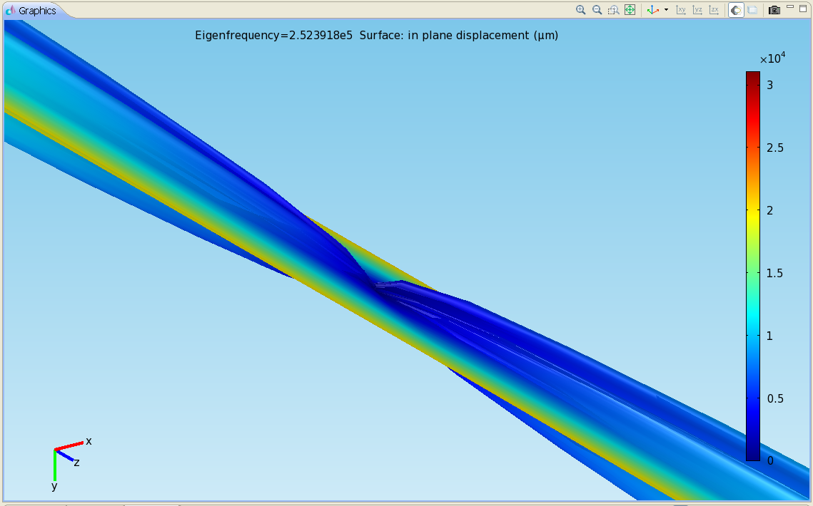

OK hold on, I spoke too soon. What I said for (b) was correct for model "1)", meaning, the 2D version, but not for model "2)", the 3D version. Both models model the same thing as described in my previous post.
Instead, in the 3D model of a thin circular wheel shape fixed near the center, when I switch from Material Frame to Spatial Frame (in Model Builder > Results > Data Sets > Solution 1 > Settings > Frame I see an absolutely gigantic structure that looks like two huge needles (size is 10^4 meters, where my simple disk is 100 um order of magnitude). Problem is I can't decode this strange result because I am not sure exactly what I'm doing when I select Spatial Frame.
But nonetheless I try to calculate circumference using the integral I set up before. And because there's this huge wacky needle thing on my screen of course it gives unintelligible results, pasted below.
Note that I am 100% sure I have drawn nothing else, just a disk that is fixed at the center, and there's no problem with the solver because it finds the eigenmodes just fine.
Here are the "circumference" values for 100 um disk. As you can see, the middle column shows the Material Frame, which is 314. ... um as expected, and the third column shows wacky results from the Spatial Frame.
Eigenfrequency Circumference (um) Circumference (um)
252391.75320385315 314.1592635789951 1.623440559667125E7
252462.48315567407 314.1592635789951 1.623689285870829E7
265124.98324808246 314.1592635789951 188918.80606117373
359226.26757419156 314.1592635789951 3.3520359322243933E7
359713.9581758728 314.1592635789951 3.315969456982925E7
704074.5855321788 314.1592635789951 5.27017283435382E7
704143.1352933468 314.1592635789951 5.254816078817571E7
1212816.8157309121 314.1592635789951 7.357123363177405E7
1212916.2134378508 314.1592635789951 7.453843246225077E7
1684257.0879518734 314.1592635789951 558011.9502628692

I wanted to attach images of what I mean when I say "two large needles." I know, this is super weird, I wish I understood what I'm looking at.

Wow! Great tutorial. Yes I didn't understand that "operator" does not mean "quantity," though that should have been clear from the term.
I did your tutorial and also integrated around one of the edges of the cube for both Material and Spatial frames, to make sure I could see a difference, and it worked and the units were correct.
Yet I am still seeing a very strange thing when I try to do the exact same thing on my model (i.e. integrate around an edge to find the perimeter length).
Expected: The integral around the edge for the material frame for a 100um diameter silica disk is 314um as expected.
Unusual: The integral around the edge for my spatial frame (everything else the same as before) is different for each mode, as expected, but the numbers are on the order of 1e7 um! (On the order of ten meters!) I would expect something slightly different to 314um.
Sorry for all the bizarre questions... I really appreciate you helping me with this.
I tried to attach my v4.0a file, but this site said "File size error" -- the file is 6.4 MB which I didn't think was that large, but whatever. So my file is here:
davidnhutch.com/3dDiskMechModes.zip
Note also that I don't think this is related but I am getting Warnings: The relative error is greater than the relative tolerance." I would make my mesh smaller to see if it fixes this but I run out of memory..
