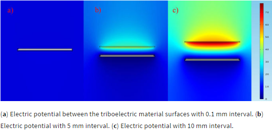

I want to find the potential difference between two triboelectric surfaces (PDMS & AL) arranged vertically. Aluminum is used as an electrode and triboelectric surface.
I want to use this equation V = σ x(t) /ε0
V=potential difference, σ= surface charge density (1 μC/m2) , x(t)= distance between the surfaces, ε permitivity.
I want to vary the gap distance between the surfaces and check their effect on potential difference.
I want the result like shown in the attached image
