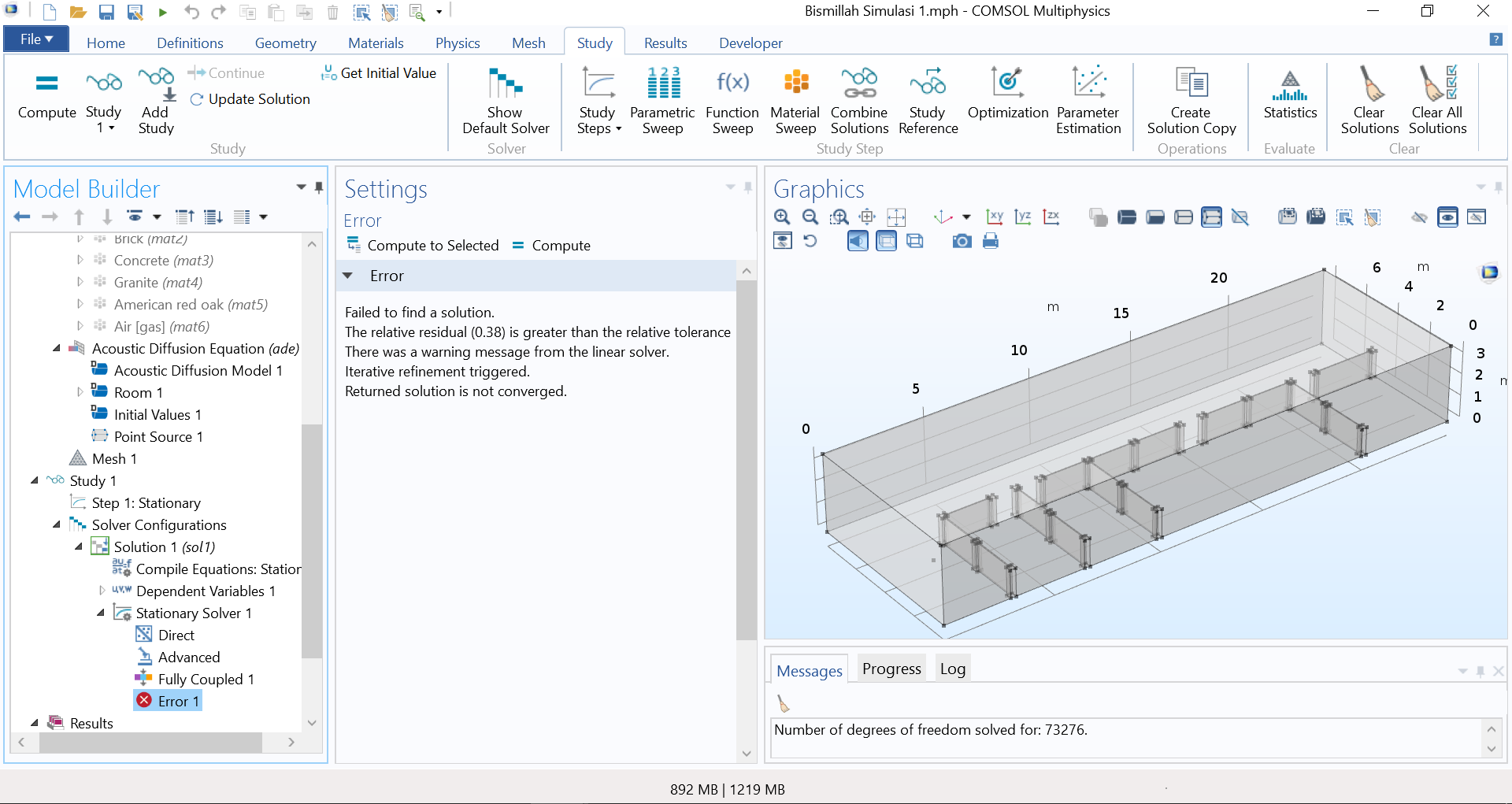

Hi Mads,
Thank you for your prompt reply.
It is very helpful. I have followed the the model which you showed to me.
However, i have the other problems. It said failed to find solution.
It happen when i computed the stationary study.
Do i need to define the power source in all band number?
