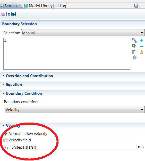

I am using the latest version, 4.2a, you may want to upgrade to it. First you need to define the function 'step1' in the Global Definition section (please see the manual) then you need to write in the inlet conditions something like:
v_in*step1(t)
T_in*step1(t)
Cheers
Hi, I am using the latest version, 4.2a, you may want to upgrade to it. First you need to define the function 'step1' in the Global Definition section (please see the manual) then you need to write in the inlet conditions something like: v_in*step1(t) T_in*step1(t) Cheers

Posted: 1 decade ago Nov 8, 2011, 9:40 a.m. EST
You really need to have a look at the manual to understand the functions section. In the meanwhile you can try to have a look at the screenshots of the file I uploaded before.
Cheers
Hi, You really need to have a look at the manual to understand the functions section. In the meanwhile you can try to have a look at the screenshots of the file I uploaded before. Cheers
Carlos Perez de la Blanca Castellano
Posted: 1 decade ago Nov 8, 2011, 11:11 a.m. EST
Hi Amir,
Thank you very much for the images!!!!!!!!!!
Of course im still doing,trying to understand this function.Im also looking in this forum about that,but the more similar examples,they have 2 temperatures,i mean,they want to start at 300K and reach 500K after 20 seconds,for example,or something like that.
I just have 1 temperature,i dont know the other one at the final(i want the program to calculate it),so....that is why you are telling me to apply step function also in velocity???

Posted: 1 decade ago Nov 8, 2011, 11:30 a.m. EST
Let us put it this way: have you ever heard of a car able to speed up from 0 to 100 km/hr in zero seconds? No? Well that is because it is not possible, it is not physical.
Exactly in the same way it is not possible to have a fluid going from zero to a finite velocity in zero seconds, therefore you need to describe the inlet velocity going up from zero to the desired value.
Cheers
Hi, Let us put it this way: have you ever heard of a car able to speed up from 0 to 100 km/hr in zero seconds? No? Well that is because it is not possible, it is not physical. Exactly in the same way it is not possible to have a fluid going from zero to a finite velocity in zero seconds, therefore you need to describe the inlet velocity going up from zero to the desired value. Cheers
