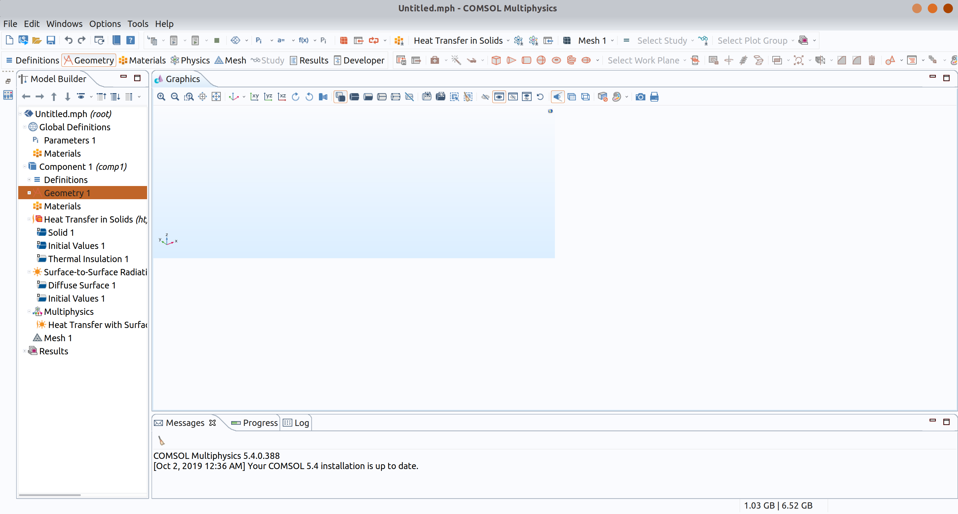

Hi, I have COMSOL 5.4 on my laptop running Ubuntu 18.04. The problem is that the graphics window does not fill the reserved screen field. Instead, it only occupies a very limited region which makes the modelling process quite difficult. I am attaching the screenshot. I would appreciate any response regarding my issue.

COMSOL 5.4 doesn't support UHD Linux displays. This will be fixed in COMSOL 5.5, tentatively to be released in about one month.
