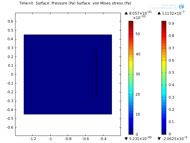

I have a simple 2D model with a Gaussian pulse, looking at transient acoustic-structure interaction. The model simply has a point sound source in air a distance away from a metal rod.
I am plotting the pressure in the air and the von Mises stresses in the metal rod. However the stress in the rod evolves before the sound pulse has reached the rod.
Please see the attached GIF of the first 0.01 milliseconds of the model.
Given the speed of sound in air the pulse should reach the bar at 0.001 seconds. However stresses can be seen in the bar much before this time (at all time increments).

The Mises stress in your animation is of the order of 1e-30. What you’re seeing is just numerical round-off errors.

If you plot the average von Mises stress within the metal bar you see it increase from insignificantly small magnitude to realistic stresses ONLY when the pressure wave reaches the bar.
