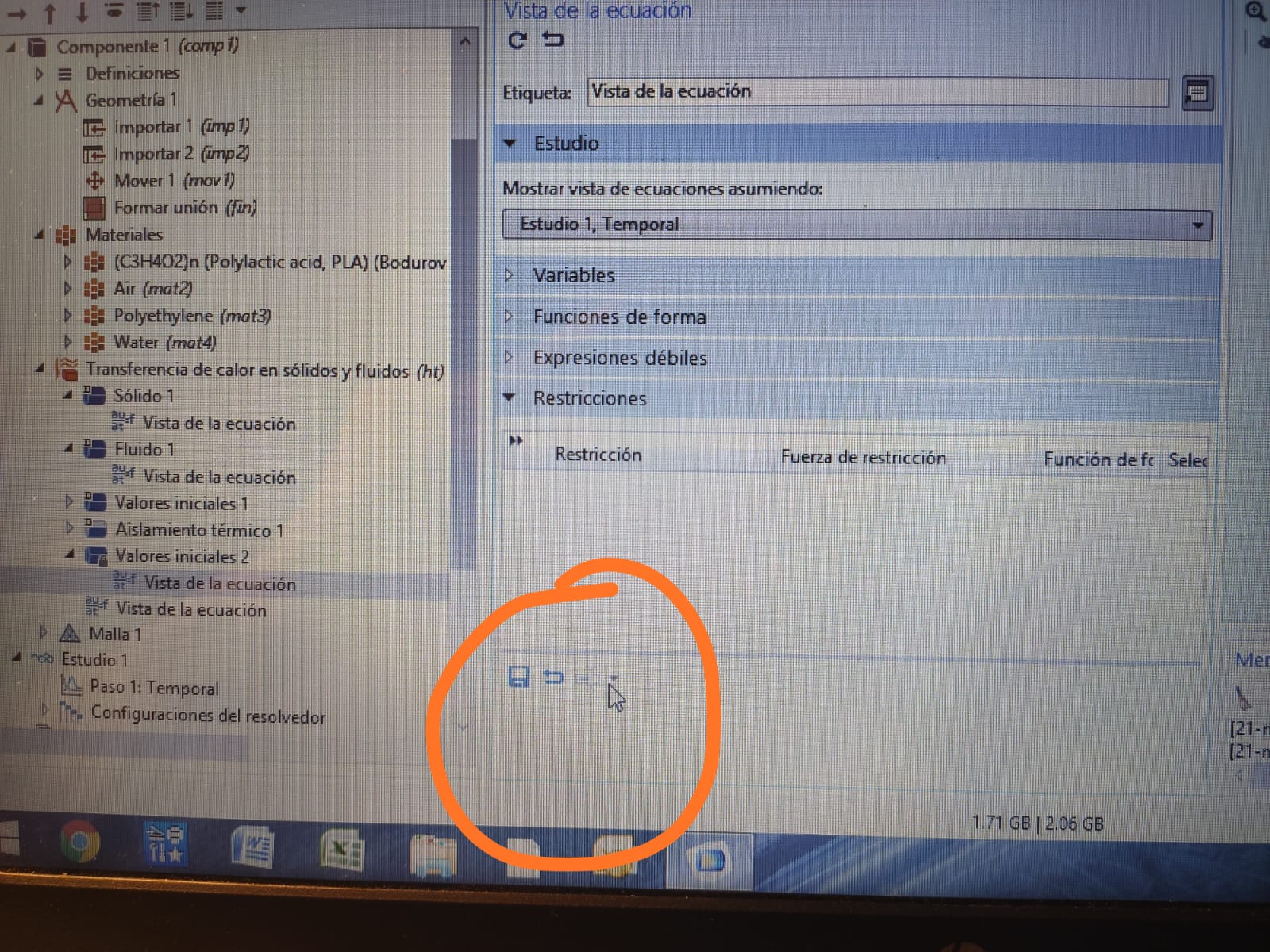

I am trying to simulate a heated flow (always at 37ºC) through a structure at ambient temperature (20ºC). To make calculations easier for comsol to avoid long calculation times, I am definig it as a liquid without movement (so I eliminate laminar flow, I leave heat transfer in solids and fluids only). The problem comes when I try to keep this temperature always at 37ºC, because I am defining an initial value of 37ºC but when time passes, the heat "flows" to the structure so the fluid ends up being at 34ºC. How can I fix the temperature of the fluid at 37ºC. I am trying to add a constraint but I don't know how.
