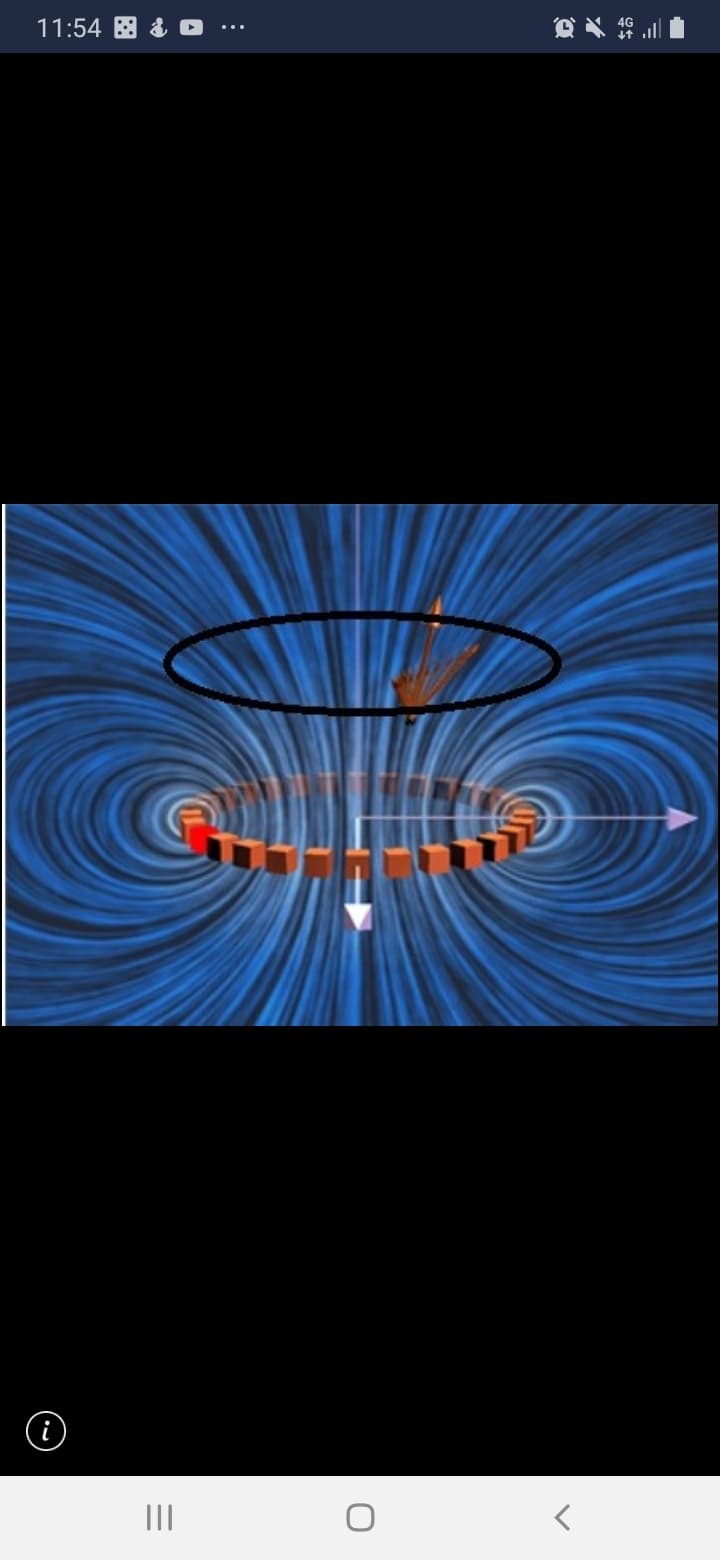

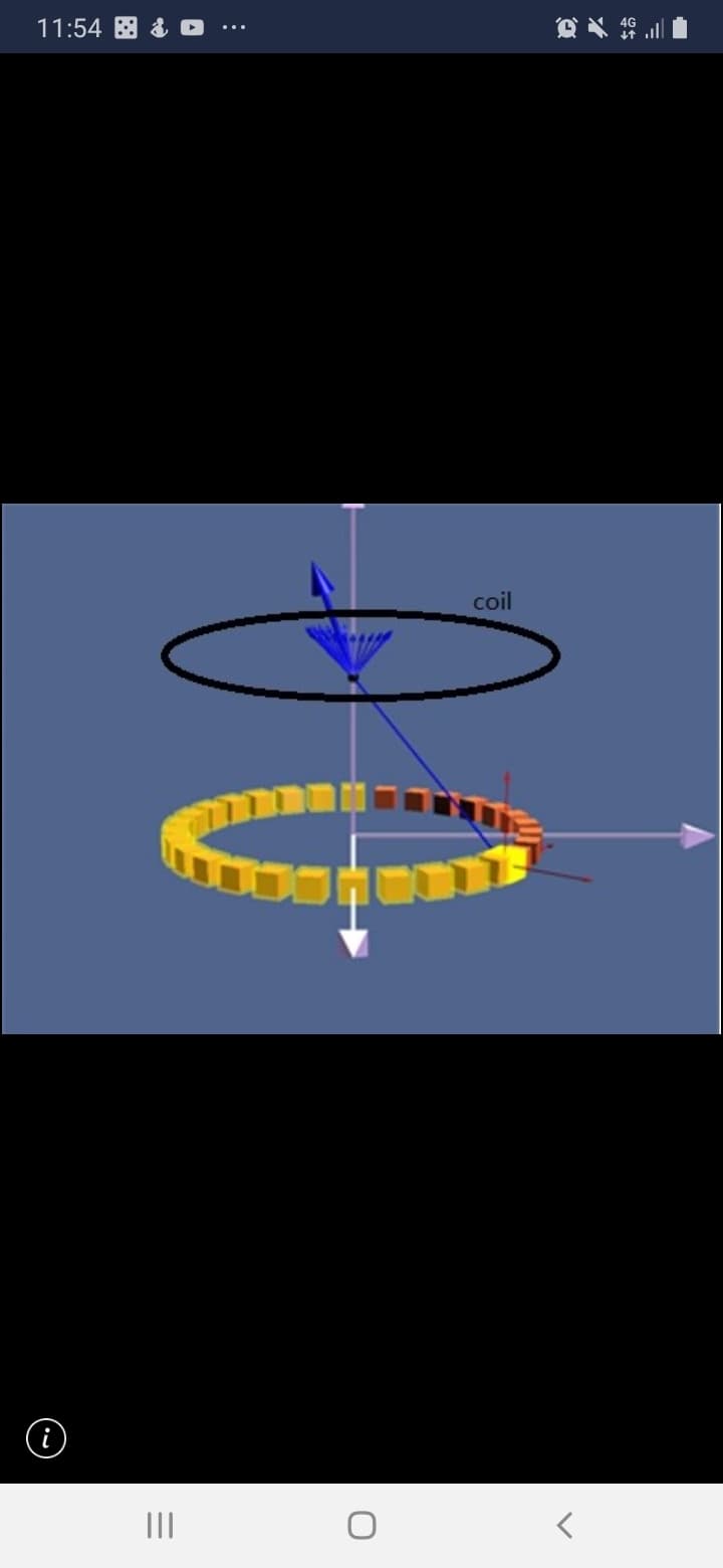

How to induce voltage in a circular coil due to the rotation of circular array of magnets in its premises
Rotor in my model is already rotating, but no voltage induces in the coil. I don't know what I have not defined in it. Can anybody have a look at it for me and guide me?
1 Reply Last Post May 6, 2020, 6:12 p.m. EDT
Posted: 5 years ago May 6, 2020, 6:12 p.m. EDT
Updated: 5 years ago May 6, 2020, 6:13 p.m. EDT
  1. It might be a good idea to post your model to the forum so others can see what you did in detail. This would probably help a lot.
  2. Are your rotating your magnets and/or coil in a manner such that the magnetic flux going through the coil is staying constant? If so, that would explain why you are not inducing any emf.
1. It might be a good idea to post your model to the forum so others can see what you did in detail. This would probably help a lot. 2. Are your rotating your magnets and/or coil in a manner such that the magnetic flux going through the coil is staying constant? If so, that would explain why you are not inducing any emf.
