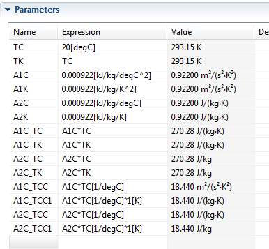

The easiest is to open a new blank COMSOL session and play with the GLOBAL Parameters
cut out and save the txt below in a txt file, then load it into your Param list (result in the png)
TC 20[degC]
TK TC
A1C 0.000922[kJ/kg/degC^2]
A1K 0.000922[kJ/kg/K^2]
A2C 0.000922[kJ/kg/degC]
A2K 0.000922[kJ/kg/K]
A1C_TC A1C*TC
A1C_TK A1C*TK
A2C_TC A2C*TC
A2C_TK A2C*TK
A1C_TCC A1C*TC[1/degC]
A1C_TCC1 A1C*TC[1/degC]*1[K]
A2C_TCC A2C*TC[1/degC]
A2C_TCC1 A2C*TC[1/degC]*1[K]
Hope I didnt miss anything, one gets easily confused I agree ;)
