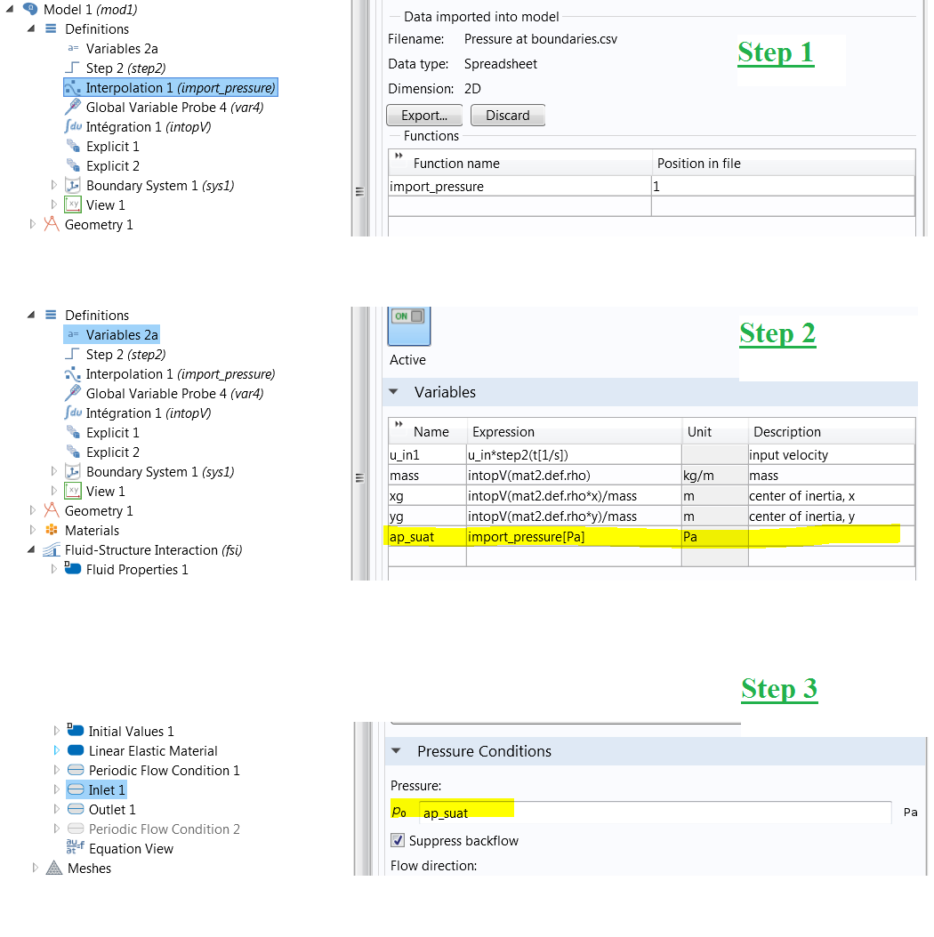

This is too late for you but it may be useful for others.
In Model 2, you create a new variable and point it to the imported function.
In your boundary condition, use the variable.
See the image for more details.

When you call a function, you need to call it with an argument, like rcomp(r) not simply rcomp.
I hope this helps.
