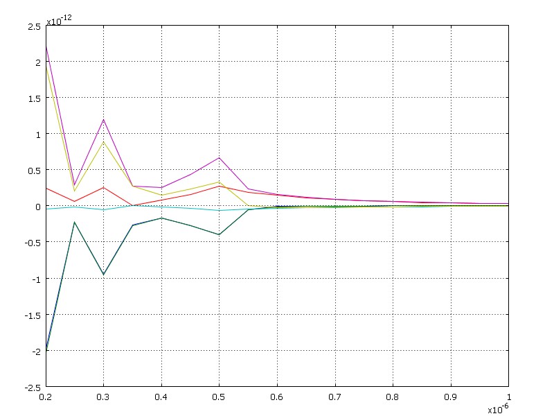

I only got started with COMSOL and was very happy to find the Model 'Mie Scattering off Plasmonic Nanoparticle and Radar Cross-Section Computations'. I followed all the instructions, but when I tried to do the mesh, it wouldn't let me do the swept mesh at first, saying there are involuted elements (even though I followed the instructions to the letter)...
I tried the swept mesh some more and suddenly, it was working fine - until, after 2 hours of calculation time, I saw the results: lots of warnings about an 'inverted mesh element near coordinate (9.24802e-008,9.24802e-008,2.6999e-007)' (these coordinates change slightly when I solve again) and a global variables plot which looks completely unlike the one in the documentation (see attached). What is going on here? I'm at my wit's end...

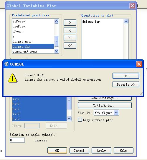

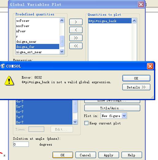

Hi, I am happy to find your example about radar cross section. But I met a problem when I fllowed your example. It happend in Global Expression(dsigma_near, dsigma_far). When I want to plot 4*pi*sigma_back, I met the problem as fllowed: disgma_far is not a valid global experssion. I do not know why.

I believe there is a quick reply for your units issue the "r/1[m]" this gives [m] if "r" is without units, or [m^2] as I expect "r" is in [m] and is different from "r/(1[m])" which is without units or equivalent to understanding it as (r[m])/(1[m])
Will have to look closer for the global expression, but I'm a t a Comsol course just now ;) and Ihave to liten to the speaker too ;)
Have a nice day
Hi I believe there is a quick reply for your units issue the "r/1[m]" this gives [m] if "r" is without units, or [m^2] as I expect "r" is in [m] and is different from "r/(1[m])" which is without units or equivalent to understanding it as (r[m])/(1[m]) Will have to look closer for the global expression, but I'm a t a Comsol course just now ;) and Ihave to liten to the speaker too ;) Have a nice day Ivar

There is serious discrepancy between my results and in results given in the presentation (different field enhancment and cross-sections that are negative at some wavelengths). I used my own data for the refraction index though it also was teken from johnson&christy (1972) paper - I've built interpolated functions with dependence on the wavelength.

I have the same problem with the model; for some wavelengths the scattering cross section becomes negative which makes, of course, nonsense. First I thought it was probably a mistake I made while defining the global expressions or the integration ones, so I repeated the process several times but I obtained the same result over and over. Later I thought that maybe one of the steps in the documentation file was wrong, so I ended downloading the file .mph directly from the model gallery instead of trying to reproduce it myself. Everything was already defined in the file so I just had to mesh the model and solve it. To do so I followed the instructions (mesh size, number of layers in the exterior subdomain, solver parameters,...) exactly as they were written in the documentation. It was a big surprise to find out that I had exactly the same problem as before. I wanted to attach the scattering cross-sections obtained with the downloaded file (Mie_scattering_plasmonic_reset_35a1.mph) to illustrate the problem but the attach button is not responding. Anyway, any idea about what could be wrong?

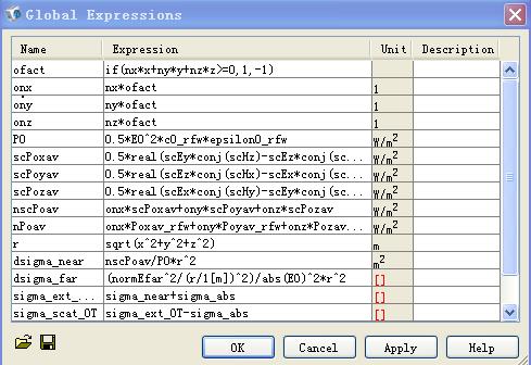

I am trying to use the variables defined in the Mie scattering tutorial and have found out that sc should be replaced with mod1.rfw.rel, for the E components and just rfw. for the H components. For example 0.5*real(mod1.rfw.relEx*0.25*conj(relHz)-mod1.rfw.relEy*0.25*conj(relHx)). The power variables are called Poavx instead of Poxav and the sc should again be replaced with rel. Poxav_rfw is mod1.rfw.Poavx in v4.2a.
But even though I have changed this in my model I can't get it to work because I still get the error "unexpected unit of input" for the dsigma_far variable : (normEfar^2/(r/(1[m]))^2)/abs(E0)^2*r^2 where r is defined as sqrt(x^2+y^2+z^2)
In equation view under far field calculation tab I see that the normEfar is in V/m units and so is E0 so the expression should give me units of m^2 which is what I want.
Does anybody know how to fix this error?

For the units, do not forget that orange unit flagging is only a warning, it will solve in any case, (but it might be wrong)
it could be that abs() is not passing the units, try it out in a post processing field
Hi Indeed naming has changed quite a lot between 3.5 and v4. For the units, do not forget that orange unit flagging is only a warning, it will solve in any case, (but it might be wrong) it could be that abs() is not passing the units, try it out in a post processing field -- Good luck Ivar
