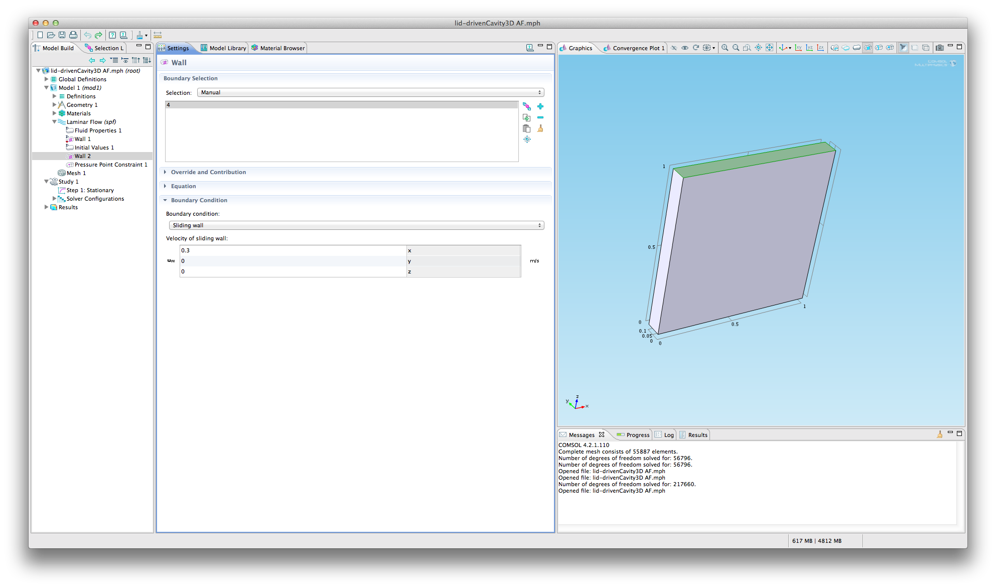

I was very interested to see your model "lid-drivenCavity3D AF.mph" that you posted so helpfully on this thread. I am currently trying to build a 3D driven-cavity model in order to understand how COMSOL Multiphysics operates in a 3D geometry. My question is rather basic:
How did you enter the value of 0.3 m/s for the sliding-wall boundary condition on boundary #4?
I have been trying to build a model exactly like yours, with a solid 3D block and an added wall condition set to 'Sliding wall'. I get the table of velocity components (all set to zero initially) but when I try clicking on the table to change a value of a velocity component I always get an 'unexpected error occurred' box coming up on the screen. I cannot see any other way of changes these values.
I am using Comsol 4.2a on a Mac running OS 10.9. It looks like the attached screenshot on my computer.
Any help most gratefully received.

I directly input any value I want in the box of the boundary condition. If you get the 'unexpected error', I would say you may have issues with your geometry. I usually receive such an error when something goes wrong in comsol with complicated geometries.
Have you started the model from scratch? There may also be compatibility issues between 4.3 and 4.2.

Hello again. Many thanks for your reply - I really appreciate it. I now have version 4.3 running under Windows 7, and it works exactly as you describe. I think it was a problem with upgrading to OS 10.9 on my Mac setup. I will run from the PC from now on!
