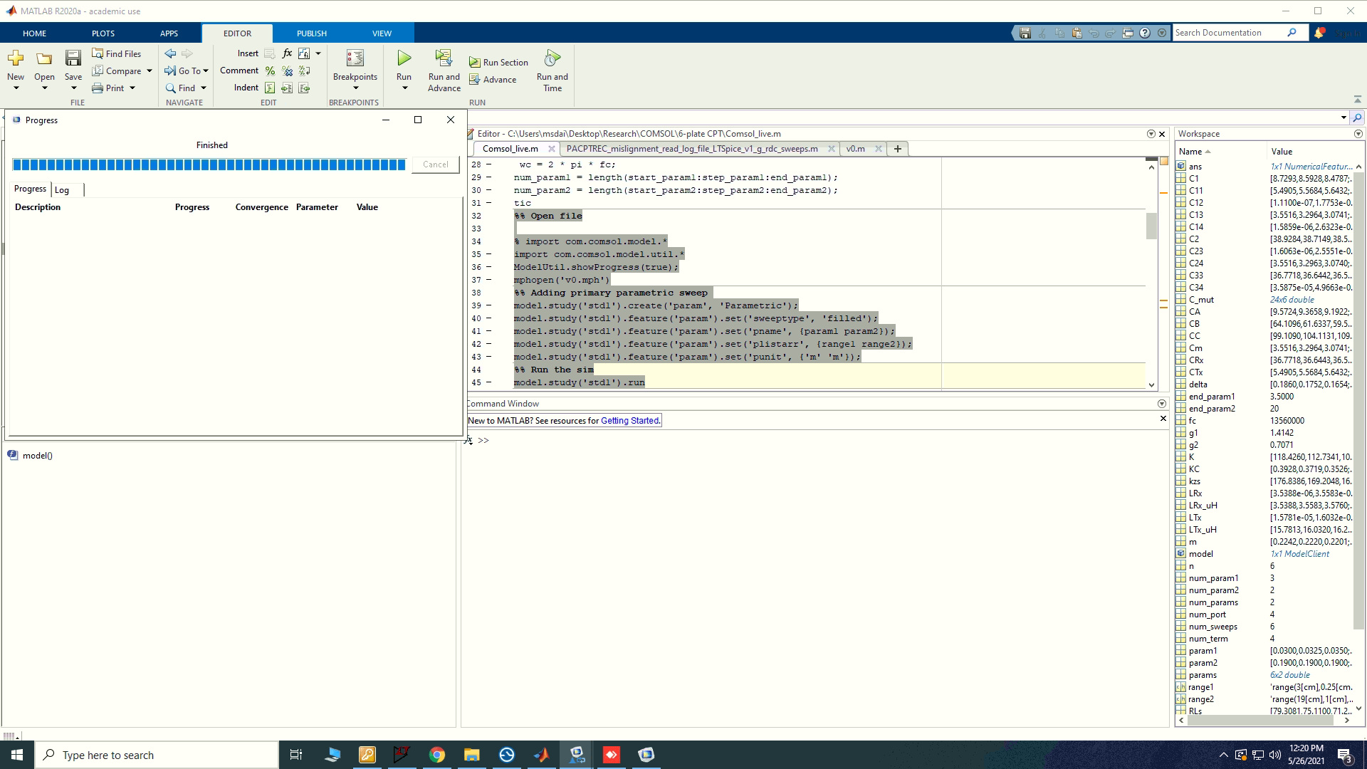

ModelUtil.showProgress(true) belongs to a COMCOL library that needs to be imported into Matlab. This is done through "import com.comsol.model.util.*". Note that this is also done in the MPH-file. If you open the m-file of your mph-file, it is your second line. For some strange reason, Matlab likes to have the libraries before openning the mph-file. I did so and it worked! Now I see the progress bar without any error throughout the simulation. Here is the final code:
%% Importing library import com.comsol.model.util.* ModelUtil.showProgress(true);
%% Openning file mphopen('v0.mph')
%% Adding primary parametric sweep model.study('std1').create('param', 'Parametric'); model.study('std1').feature('param').set('sweeptype', 'filled'); model.study('std1').feature('param').set('pname', {param1 param2}); model.study('std1').feature('param').set('plistarr', {range1 range2}); model.study('std1').feature('param').set('punit', {'m' 'm'});
%% Run the sim model.study('std1').run
The progress window does not pop out as it is a subcategory of the DOS command window that creates the livelink. Windows however notifies you where you can find it. This is what has worked for me and hope works for you too. I wish the COMSOL sopport team spent more time on explaining how these prompts work together.
