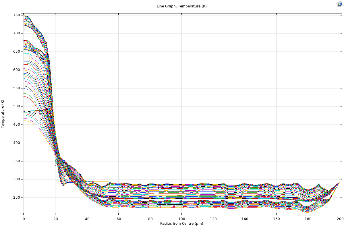

This works great for the first pulse, however, for multiple absorption cycles, the temperature between the focal spot and the disk edge goes below ambient. This is unphysical and I think related to the solver or my poor temperature initalisation that causes a clear jump at the focal spot - large disk edge.
Attached is my model where I have also added descriptions, which executes in 5 seconds on a MacBook Pro 2018. Also attached is a plot of the radial temperature, showing the increase of focal spot temperature, the ambient disk edge, and the oddly dropping central temperature.
