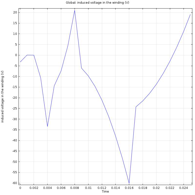

at 127 rpm and 32 poles it takes only 0.015s to rotate from 1 pole to the next. Is your time stepping too coarse and you are observing just an aliasing result?
Cheers
Edgar
Cheers
Edgar

As i said i am using for time stepping "linspace(0,0.03,30)". I have already increased it for linspace(0,0.03,100) but the bad induction presists. I thought that with more steps the problem should be gone but it didn't. Is this what you are suggesting?
Do you think that i should increase it even more?
Thank you for you reply.
Best regards,
José Cardoso
Best regards,
José Cardoso

Sorry, I got the syntax of linspace confused. The time stepping is probably ok. You might still check if you chose explicit timing in the solver.
Another issue might of course be the meshing.
Cheers
Edgar
Cheers
Edgar

Sorry to ask but what is the "explicit timing"?
I tried to attach the file of the comsol but it is too big. I will try to attach 1/8 of my generator so you could see what is wrong if you don't mind.
For the mesh i set it to "Finer" and then make for 2 in "Resolution of narrow regions" like it was in one of the models.
Thank you again for your support sir.

I think what i had was indeed a aliasing result. I can get now a sin wave for my induction voltage.

I am also getting the bad induced voltage in my generator.
Iam using a line space of (0,0.01,0.25)
Will you please let me know how you get the sine wave for the induced voltage?
Thank you.
