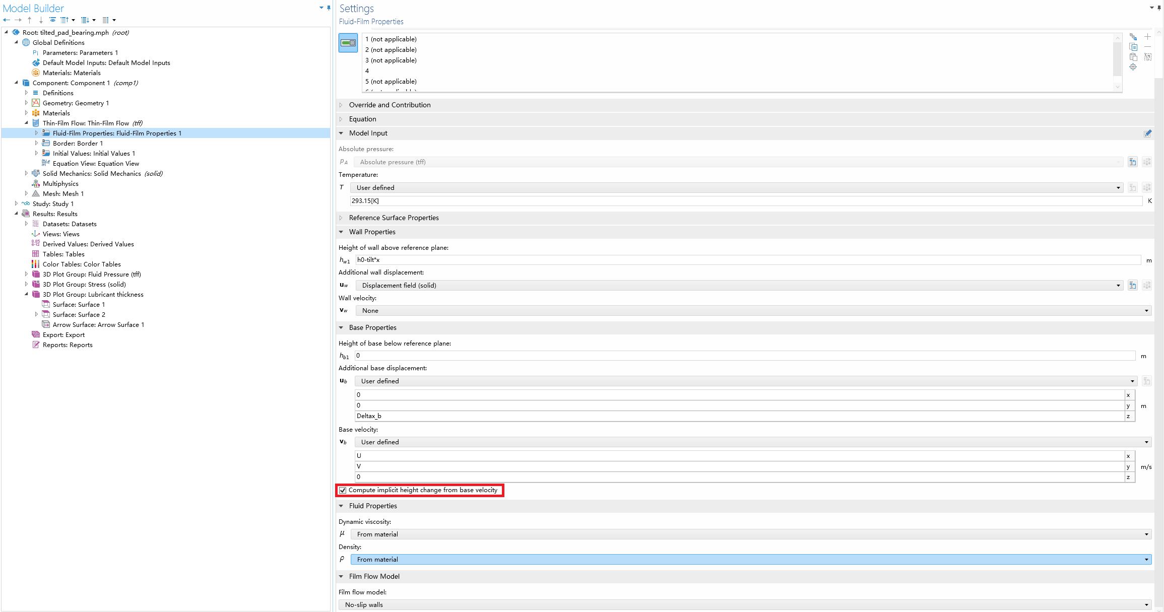

I am trying to predict the experimental results of plain bearings with the COMSOL thin film flow module. However, I am confused by the option 'Compute Implicit Height Change From Base Velocity' in Fluid-Film Properties, which is not explained in the documentation and can have a significant impact on the results. (The attachment shows the location of this option)
What does 'Compute Implicit Height Change From Base Velocity' mean in the Thin Film Flow module?
