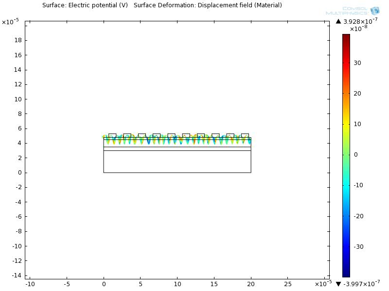

Thank you for your reply. I still have a few questions based on your comments about the model. But first ultimately what I wanted to do was first obtain the resonant frequencies of the SAW device, then study the changes and shifts in the device as I added a sensing layer to the center of the device and then when the sensing thin film material interacts with a gas. I wanted to be able to obtain results ultimately with my 3D model but I have scaled down to a 2D model to simplify the device and figure out where the issues I have had. I originally used an eigenfrequency study and obtained some various surface and potential plots at various frequencies I designated. Then for later models, I proceeded to add a frequency domain analysis.

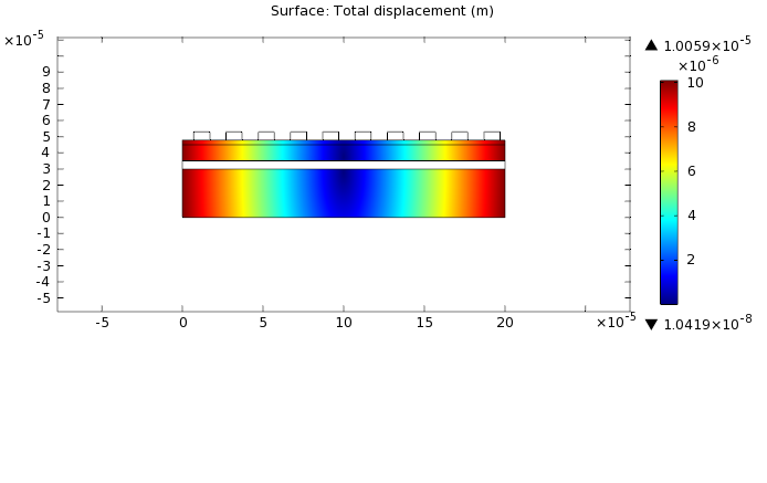

In total, you have 14 domains. Domain #4 is active in the Piezoelectric Material Model, domains #1 and 2 are active in the Linear Elastic Model 1, and the rest domains are active in the Electrical Material Model. It means that you are not solving structural mechanics equations in the domains 2, 5-14.
If you plot displacement field, you will see that only domains 1, 3, and 4 are colored, while the rest domains are white, as shown in the attached Figure. You need add all “white” domains into Linear Elastic Model node.
You do not have any structural constraints in the (pzt) physics interface, only electrical constraints are imposed. Thus, rigid motion is not excluded.
I think that plane strain is more appropriate for you model.
