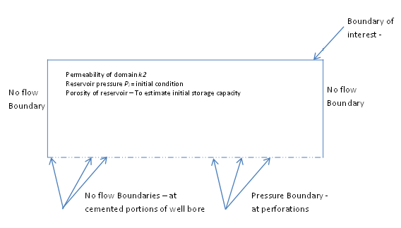

For my simulations so far, I have observed that the domain solution depends on the prescribed values of the boundary condition, i.e I have to specify Dirichlet boundary conditions of stress, pressure or velocity along the top and bottom boundaries. The Side boundaries are specified as No- flow.
The Comsol user guide suggested that the use of Open Boundaries ( with No viscous stress) might be useful in obtaining solutions in cases where pressure cannot be predicated ahead of time, as such I am trying to run the model using the Brinkman's Interface in order to take advantage of the open boundary physics for the top boundary, along with a specified condition along the bottom of the model. However, I have been unable to get my model to converge with this specification. (The mph file and model diagram file is attached)
