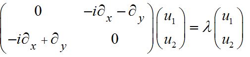

Here I encounter another problem. Under the PDE, I try to solve the coupled PDEs of the first order. You can refer to the attachment for the equation. I found that the solution is very nonphysical as the eigenvalue should be real. Moreover, the eigen wavefunction looks very strange (there should be a standing wave). Would you please take a look?

Thank you for your information about 'lambda'. I recognized that 'lambda' can be eliminated by solving a coupled PDE equivalently (refer to the attachment in the reply to Josh). However, this time another problem appears, which I don't know how to deal with. The eigenvalue should be real (there are always imaginary parts in the results) and the eigen wavefunction looks strange.
Would you please take a look at the attachment above? Thank you so much for your help.
