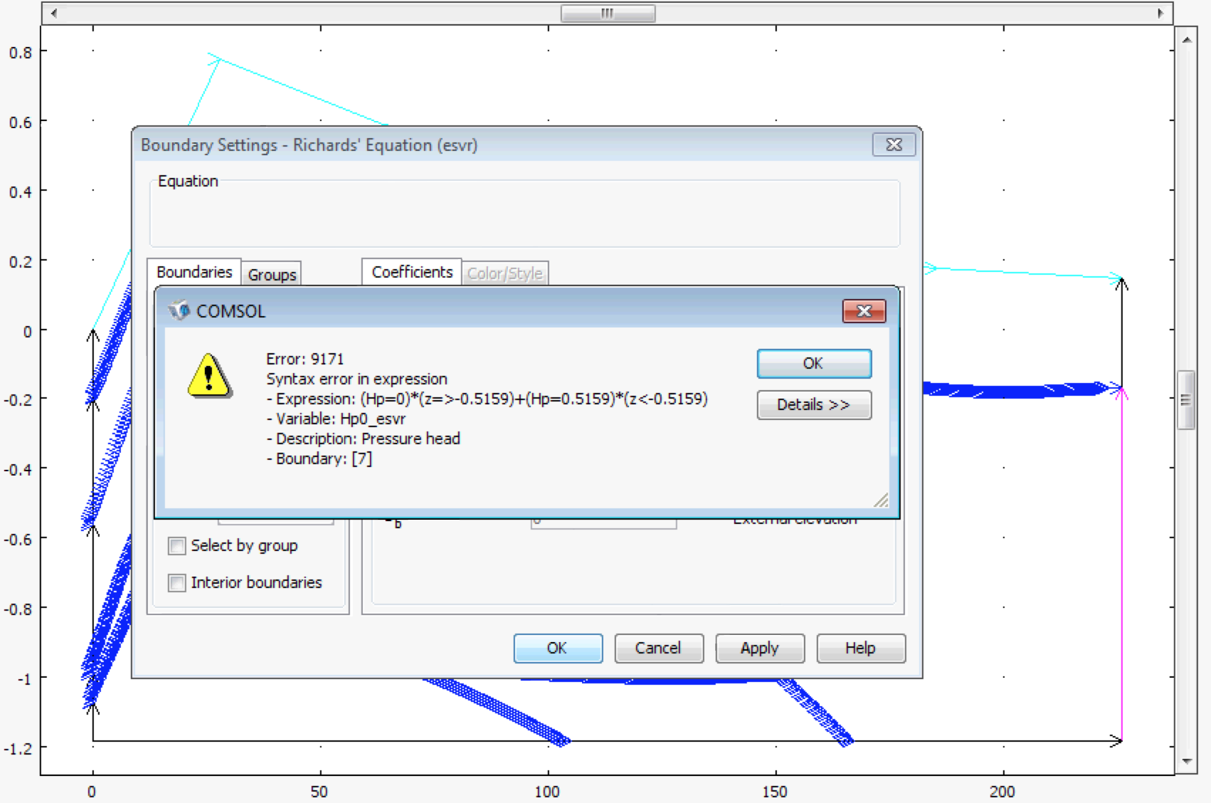

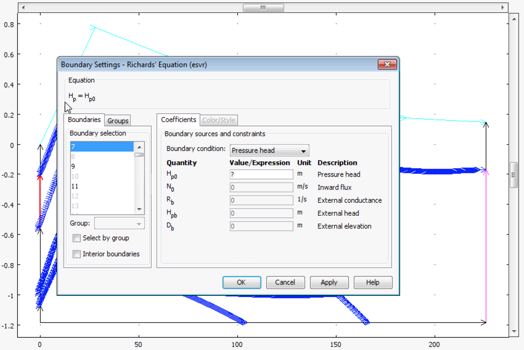

I want to define two conditions for one part of rectangular that I have in 2D (xz) and put two different value of pressure head in one boundary condition,
like Hp=0 if z>= - 0.5159m
and Hp=0.05159 if z< - 0.5159m
how is it possible to write these in one boundary condition?
Attached screen shot for better explanation
5 Replies Last Post Mar 20, 2014, 11:39 a.m. EDT
Posted: 1 decade ago Mar 18, 2014, 9:47 a.m. EDT
I wrote expression in a way that I put the screenshot, But I confronted with this error,
I am new in comsol and I need your help.
Best
Sepideh
I wrote expression in a way that I put the screenshot, But I confronted with this error, I am new in comsol and I need your help. Best Sepideh

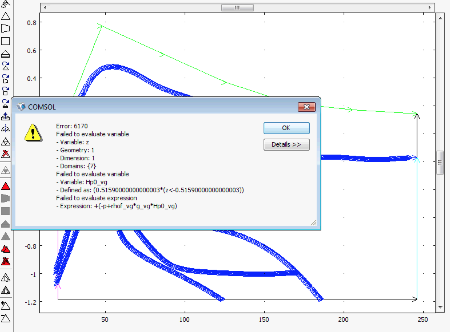

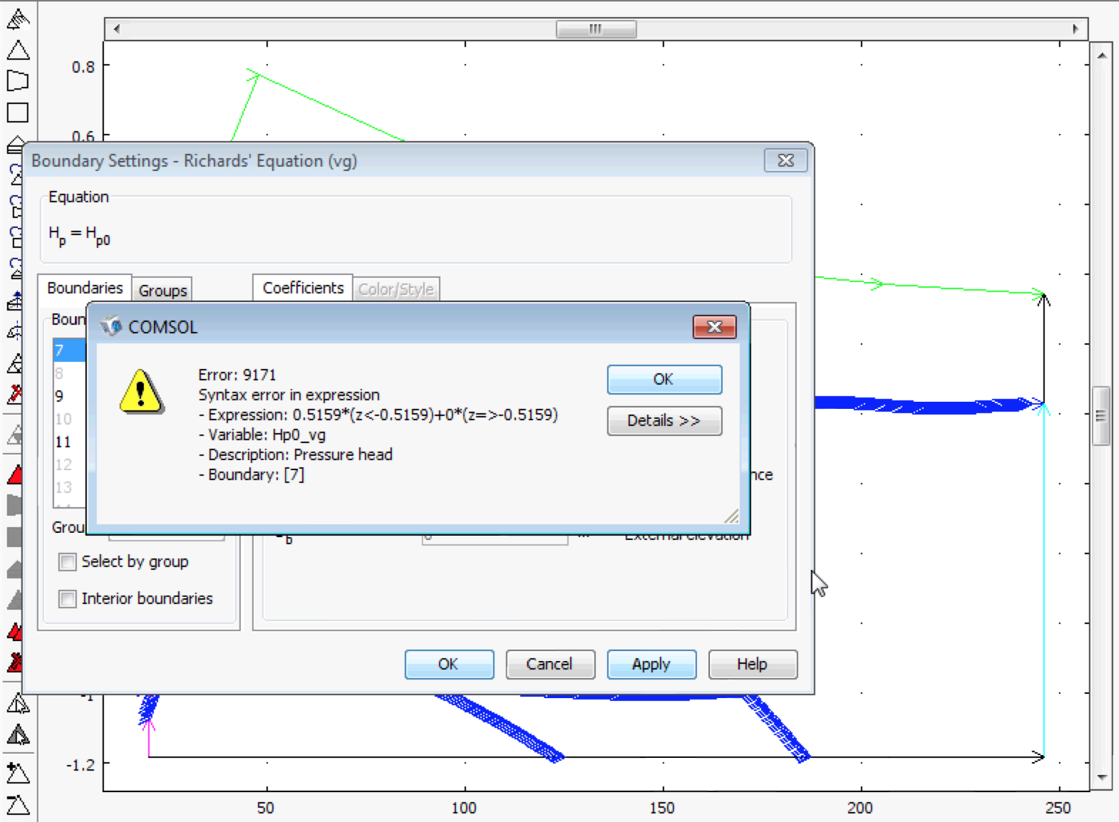

Thanks for reply Magnus,
I tried with the first expression and I confronted with error in screen shot1, and then I tried with the second expression and I confronted with screen shot2.
I am new to comsol, therefore your comments will help me a lot.
Best,
Sepideh

Posted: 1 decade ago Mar 20, 2014, 5:51 a.m. EDT
Hi again,
Could it be that none of your spatial coordinates is called z? Typically, in a 2D model, the spatial coordinate names are x and y.
Magnus Ringh, COMSOL
Hi again, Could it be that none of your spatial coordinates is called z? Typically, in a 2D model, the spatial coordinate names are x and y. Best regards, Magnus Ringh, COMSOL
Posted: 1 decade ago Mar 20, 2014, 11:39 a.m. EDT
Thanks a lot it worked with "y", and I just defined one side of rectangle for two types of condition like this
(C1*(p<p1) + C2*(p>=p1)). C1 and C2 are conditions.
Hope it helps for others.
Sepideh
