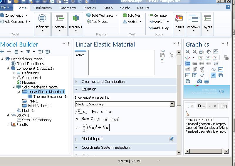

I want to add Thermal Expansion in solid structure under Linear Elastic Material.
When I see equation, theses equations are wrong for thermal stress.

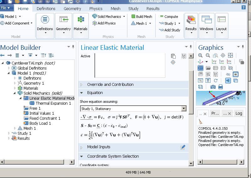

I download a example from this Forum for Thermal Expansion and see these equations are correct.
Would you please why my equation are wrong?
Please attached files.

Both are correct. One is based on the Green-Lagrange strain (for geometric nonlinearity), and the other is based on infinitesimal strains (does not account for geometric nonlinearity).
