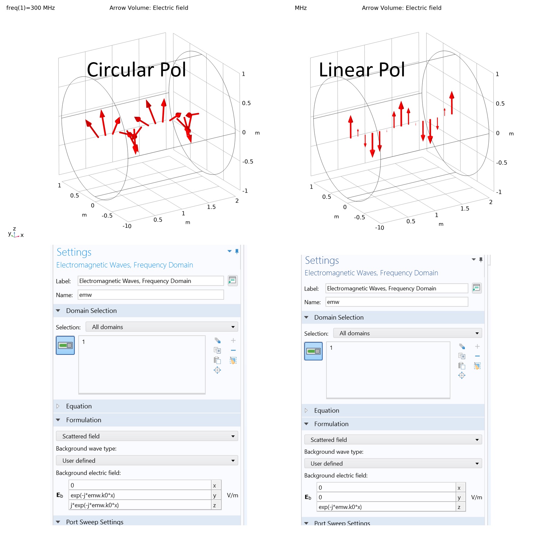

i found out a blog on circular polarization of light. I'm unable to produce circular polarized light and linear polarized light. I have try many times but it does not happened good for me. Can you kindly enlightened me on this topic. I'm very aware of the equation behind these. But unfortunately i'm unable to undersatand how i designed cicular polarized light and linear polarized light in comsol. Can you please help me in regarding this matter. can you just send a file which involve circular polarization and linear polarization Your help is much more appreciated. Waiting for your reply. Thank You.

This is straightforward to do. See the attached picture, which shows x-directed plane waves and how they were specified. One is CP and the other is LP.

Thank you sir, Actually I want to incident the LCP or RCP at 30 degree angle of incidence. So from where should i put that angle of incidence thing. Because in the background electric field, where i put the equation, there is no option for controlling the angle thing. Can you please enlighten me ? Thank You

You can specify the individual vector components of the wave. With a little thought, some pencil and paper, etc., you should be able to see how to specify kx, ky, kz, and Ex, Ey, and Ez.
(Trust me, you'll never regret practicing your vector analysis.) :) Alternatively, you can keep the wave going along an axis, but simply rotate your whole problem geometry (but that's the quick/lazy solution).

I'm new to this comsol environment and i don't have much physics background. So, can you please give me a try to produce Right Circular polarized light falling from postive firection of z-axis to the negative directive of z-axis having angle of incidence 39 degree with z-axis and azimuthal angle of 40 degree as a background electric field. This will be much more appreciate. Because currently I'm not able to understand the Kx, Ky and Kz. Please help me through this matter. This is very urgent for me. Thank You,
