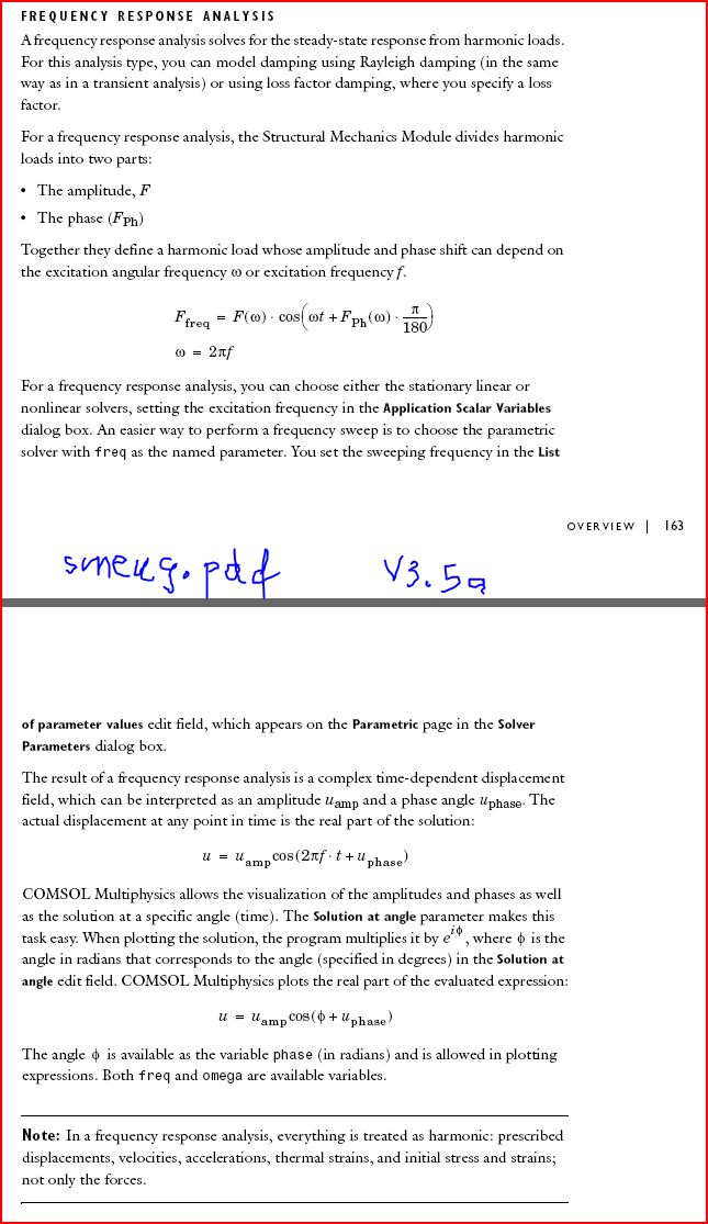

Now concerning the phase, I might not fully understand what you are searching, but you can find how the "phase" is linked in here in COMSOL , i.e. in the smeug.pdf file (an excerb is attached below), or in the knowledgbase:
www.comsol.com/support/knowledgebase/878/
www.comsol.com/support/knowledgebase/1009/
these are more related to AC/DC but they also apply by similiriaty to structural
