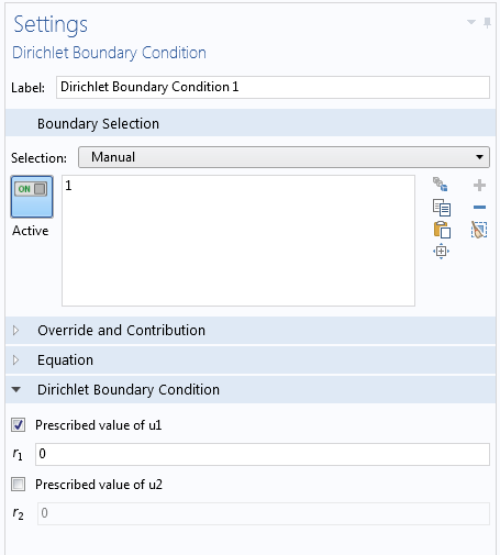

You should be able to do this by adding a Dirichlet Boundary Condition node under the Flux/Source node, and then select only the dependent variable for which you want to apply a Dirichlet boundary condition. For the other dependent variable, the Neumann boundary condition is then still active. See the attached screenshot.

Hi, You should be able to do this by adding a Dirichlet Boundary Condition node under the Flux/Source node, and then select only the dependent variable for which you want to apply a Dirichlet boundary condition. For the other dependent variable, the Neumann boundary condition is then still active. See the attached screenshot. Best regards, Magnus Ringh, COMSOL
