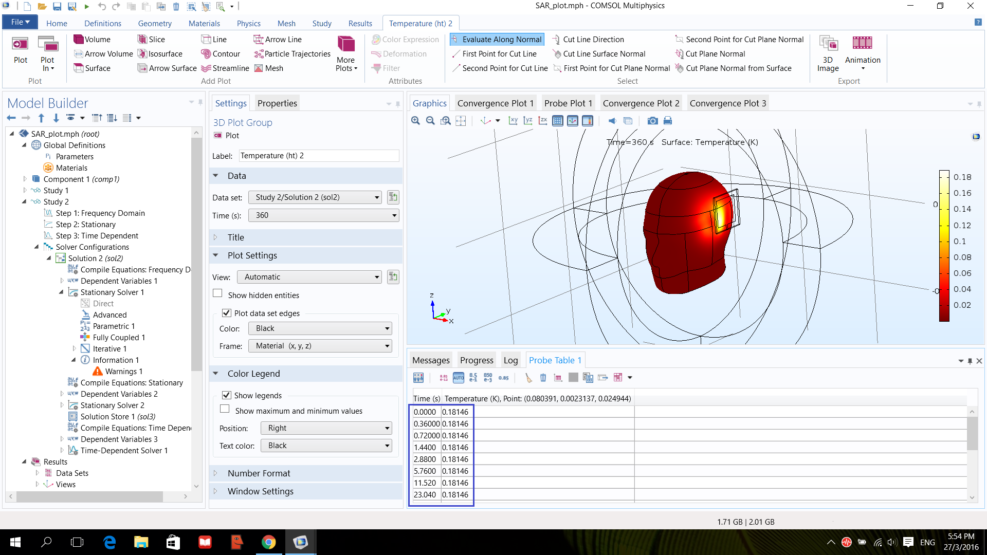

I have 1 question over here, i have been using the SAR head tutorial (Provided by comsol tutorial) to do research for my school project and i have 1 problem over here which is, i cant seems to plot temperature VS time graph. i had searched though the internet for solution and i did follow their steps but still i cant manage to get it. whatever i try to plot, the time will varies but the temperature remains the same throughout which makes my curve looks like one horizontal straight line.
I will really appreciate if someone can take a look at the attached picture (i can't seems to upload my model file here) and suggest to me what should i do next.

Anyone have any solution for the above problem? I have used the domain point probe for the above case, and run a time Vs temperature plot. The plot was successfully run but the temperature still remains the same thought out from time = 0 s to 360 s . Was wondering if there is anything i needed in the parameter or variable or ramp up to get the temperature running?

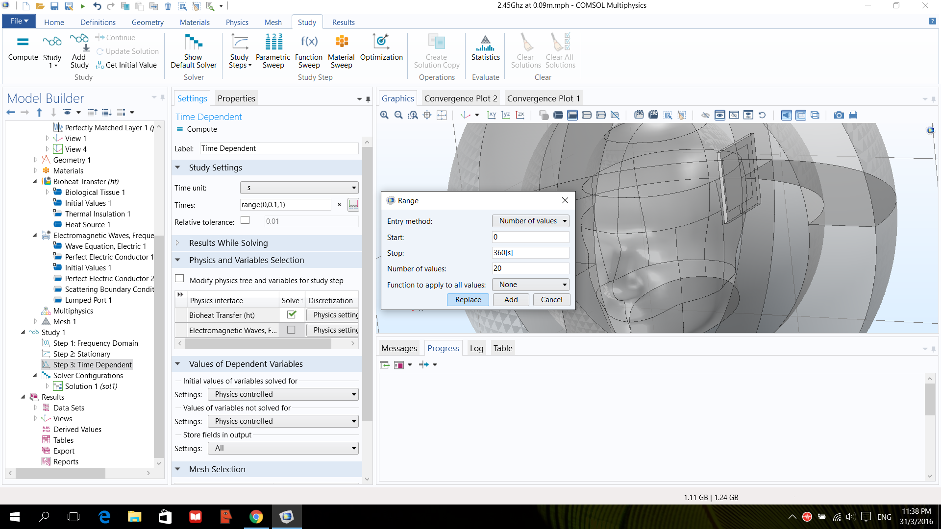

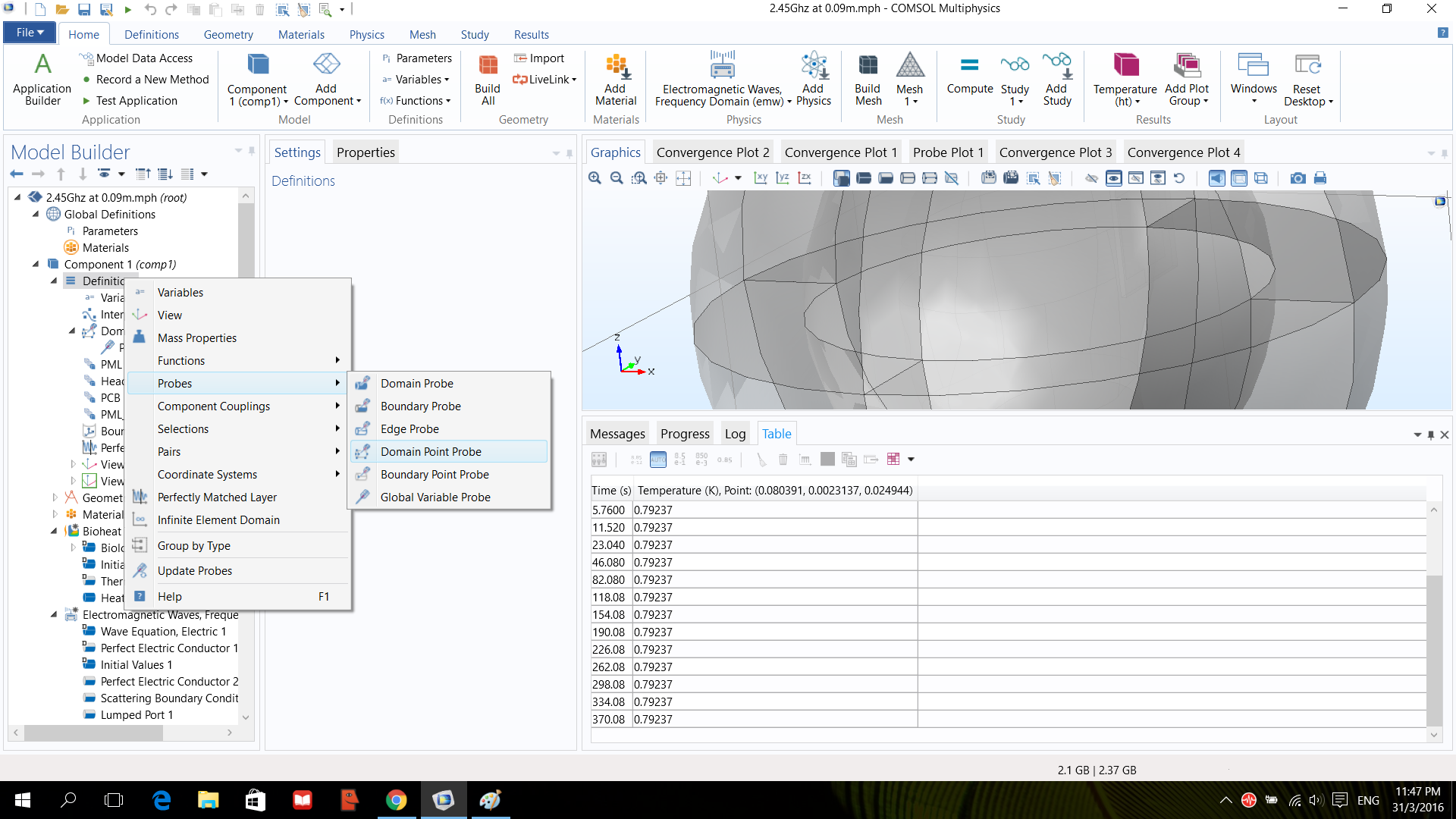

1. i was using the Domain Point Probe under definition node (see picture 1), after that i enter the x, y z coordinates and fix the point.
2. i added the time dependent solver under study nodes, and typed the range that i wish to plot with (see picture 2).

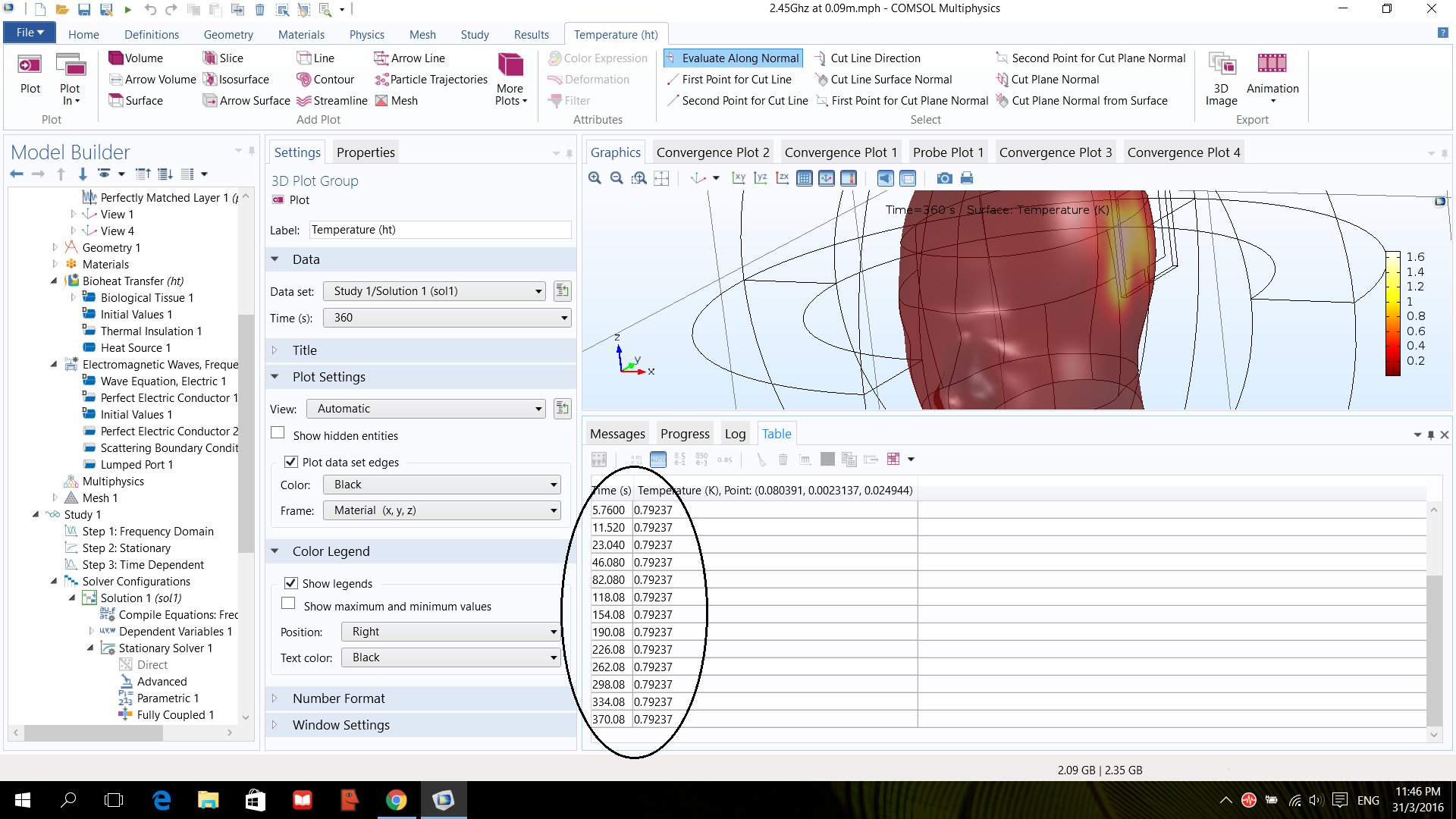

3. i press compute button and the time-dependent i got the this result (see picture 3).
