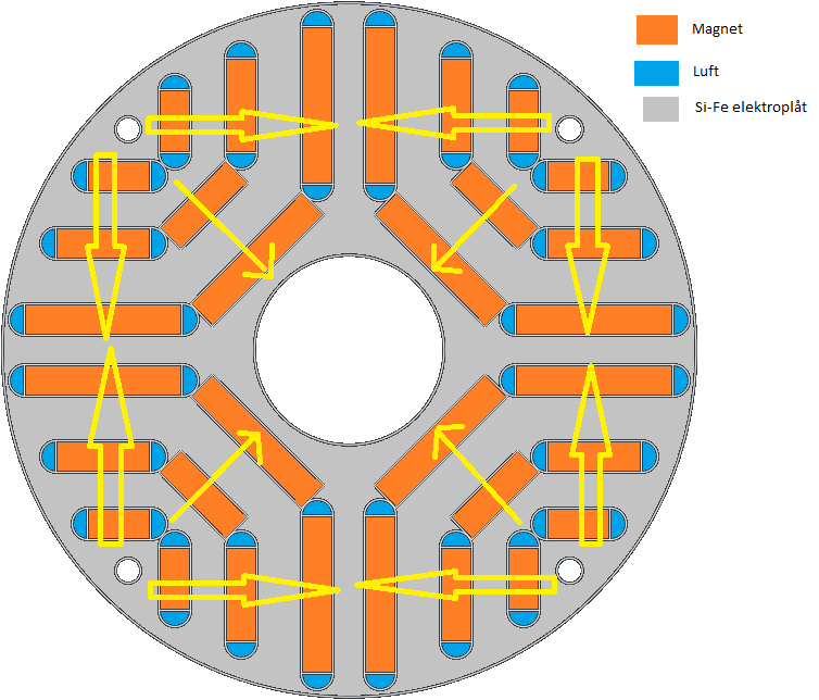

I am trying to simulate demagnetization of magnets in a rotor of an electric motor using the MF module. The magnets are supposed to be magnetized along their short axis, but it gives me the error

When i set the magnetization along their long axis everything works fine. I don't know why this is happening.

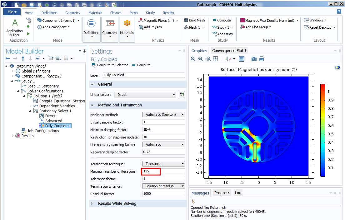

Martin,
Increase maximum number of iterations for Fully Coupled solver and solution converges, as shown in the attached image.
Sergei
Martin, Increase maximum number of iterations for Fully Coupled solver and solution converges, as shown in the attached image. Regards, Sergei
