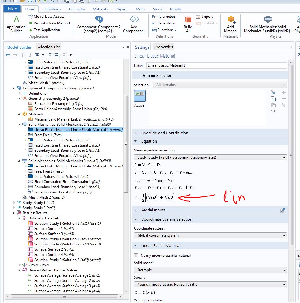

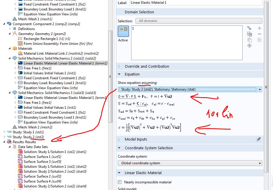

To better understand check the equations that COMSOL uses (see the jpg below, I believe you must turn on the Equation Section via the *eye* icon in the model tree (by default COMSOL hides many features to make the model tree look simpler, that is best when you start with COMSOL otherwise one tend to get lost in the thousands of menus ;)

The displacement (u,v,w) has the same interpretation irrespective of whether the analysis is geometrically nonlinear or not.
When you switch in geometric nonlinearity, two important things happen:
1. The Spatial Frame is separated from the Material frame so that x = X+u etc.
2. Nonlinear stress and strain measures are used.
The fact that z=Z for a geometrically linear problem is consistent with that it should be linear (infinitesimal deformation). You do not want a problem to become nonlinear just because for example a load is a function of z.
