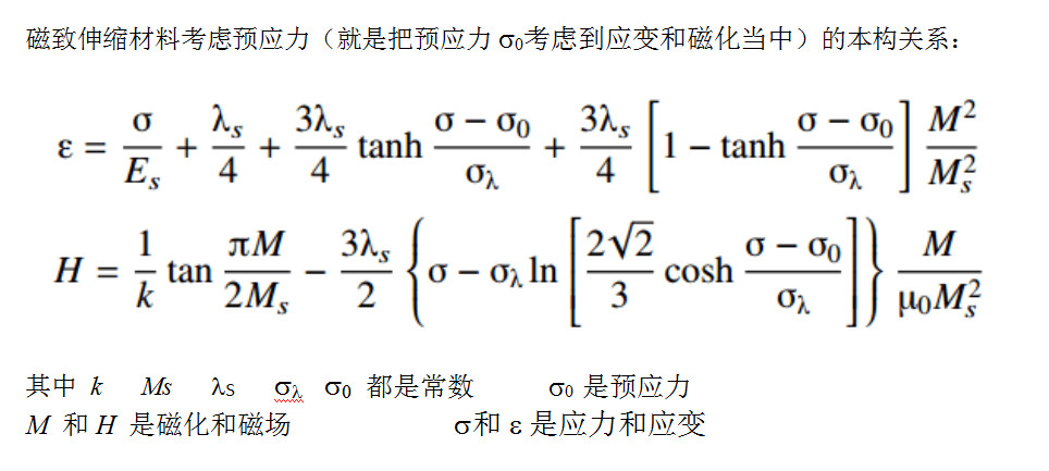

Dear 建 韩
Thank you very much, Would you please give me the references for these equations?
Thank you.
Khalid
Dear 建 韩
Thank you.
Khalid

[QUOTE]
Dear 建 韩
Thank you.
Khalid
[/QUOTE]
equations from link:http://xueshu.baidu.com/s?wd=paperuri%3A%28af5cc5306c98dfdaa9a54c6f5f90cbe6%29&filter=sc_long_sign&tn=SE_xueshusource_2kduw22v&sc_vurl=http%3A%2F%2Fscitation.aip.org%2Fcontent%2Faip%2Fjournal%2Fadva%2F5%2F10%2F10.1063%2F1.4933024&ie=utf-8&sc_us=3376686374987317399
