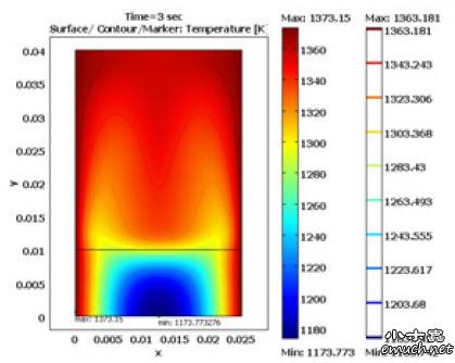

How to add the scale legend as in this graph?
How to add this scale legend (see the attached graph, the scale legend on the right, i.e. the second one)
my comsol is version 4
Thank you!

in V4 the global Legends are on the main "Results - Plot" node, while you can select the presence or absence of the color bars on the sub-nodes for the different plots under there respective main Results-Plot nodes
Hi in V4 the global Legends are on the main "Results - Plot" node, while you can select the presence or absence of the color bars on the sub-nodes for the different plots under there respective main Results-Plot nodes -- Good luck Ivar
Thank you!
I assume it is a contour plot, without fill. so one surface plot (the full color legend) and one contour plot (the discrete color one)

[QUOTE] How to add this scale legend (see the attached graph, the scale legend on the right, i.e. the second one) my comsol is version 4 Thank you! [/QUOTE] I assume it is a contour plot, without fill. so one surface plot (the full color legend) and one contour plot (the discrete color one) -- Comsol 4.1 Ubuntu 10.04.1
Thank you!
Comsol 4.1
Ubuntu 10.04.1
I think it is a contour plot too. But, it seems that there is no discrete color option in v4, I cannot find this function.
[QUOTE] [QUOTE] How to add this scale legend (see the attached graph, the scale legend on the right, i.e. the second one) my comsol is version 4 Thank you! [/QUOTE] I assume it is a contour plot, without fill. so one surface plot (the full color legend) and one contour plot (the discrete color one) -- Comsol 4.1 Ubuntu 10.04.1 [/QUOTE] I think it is a contour plot too. But, it seems that there is no discrete color option in v4, I cannot find this function.

in 4.1 it's in one of the sub-settings of the plot settings view
Hi in 4.1 it's in one of the sub-settings of the plot settings view -- Good luck Ivar
Thank you, Ivar!
Would you mind give a image snapshot?
I try to find it, but failed at last.
[QUOTE] Hi in 4.1 it's in one of the sub-settings of the plot settings view -- Good luck Ivar [/QUOTE] Thank you, Ivar! Would you mind give a image snapshot? I try to find it, but failed at last.
