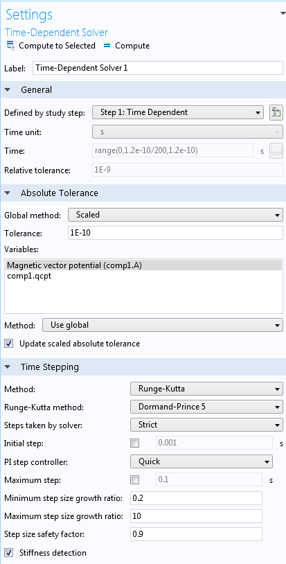

Hi Gennady, the best thing to do here is to switch to an explicit timestepping method. To do this, go to Study 2>Solver Configurations>Solution 2>Time Dependent Solver 1. In the Time Stepping tab, set the "Method" to "Runge-Kutta", and the "Runge-Kutta method" to "Dormand-Prince 5". Accuracy can be improved by setting the "Steps taken by solver" to "Strict".
With these settings, the error drops to around 0.2%. You can reduce the relative and absolute tolerances to reduce the error further. For example, at a relative tolerance of 1E-9 and absolute tolerance of 1E-10, the error dropped to 0.0004% (see attached screenshot of the settings).
This is quite a difficult test case, since the magnetic flux density is on the order of 50[T], which is extremely high.
Dan
Hi Gennady, the best thing to do here is to switch to an explicit timestepping method. To do this, go to Study 2>Solver Configurations>Solution 2>Time Dependent Solver 1. In the Time Stepping tab, set the "Method" to "Runge-Kutta", and the "Runge-Kutta method" to "Dormand-Prince 5". Accuracy can be improved by setting the "Steps taken by solver" to "Strict". With these settings, the error drops to around 0.2%. You can reduce the relative and absolute tolerances to reduce the error further. For example, at a relative tolerance of 1E-9 and absolute tolerance of 1E-10, the error dropped to 0.0004% (see attached screenshot of the settings). This is quite a difficult test case, since the magnetic flux density is on the order of 50[T], which is extremely high. Dan
Dan
