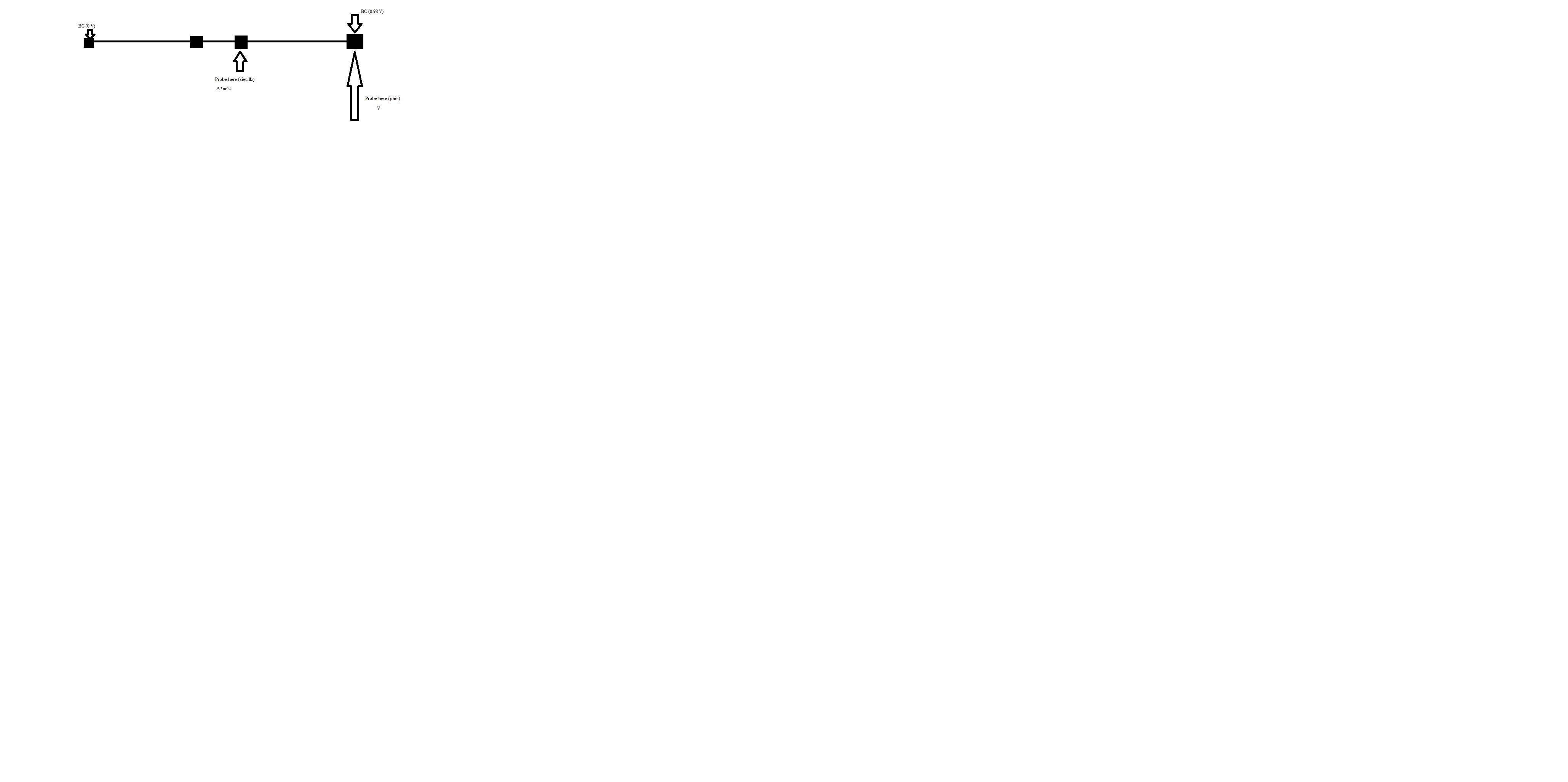

Posted: 9 years ago Sep 22, 2016, 3:41 p.m. EDT
Sorry I can't open because it was created with a new version.
Open the file where I draw in Paint a conceptual scheme where you should place your probes.
Sorry I can't open because it was created with a new version. Open the file where I draw in Paint a conceptual scheme where you should place your probes.
Posted: 9 years ago Sep 23, 2016, 6:19 a.m. EDT
