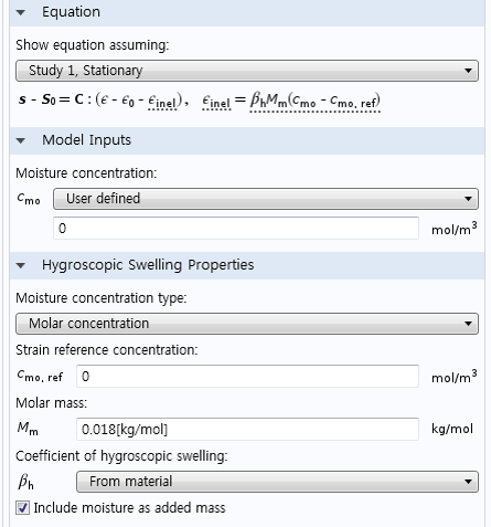

Hi. Please help me out.
In hygroscopic modelling, the moisture concentration is given in mole/m^3.
In case I have a relative humidity of 40% at a temperature of 25 degrees Celsius, how do I convert this into mole/m^3.
Thank you.

By the way, you can also select to give the input in terms of mass concentration.
Either way, the humidity in in the surrounding air serves as a boundary condition for the moisture concentration in the solid you will analyze. It is not trivial how to transform the values in the surrounding air to values inside the solid.

Posted: 8 years ago Dec 26, 2016, 4:56 a.m. EST
Thanks a lot sir. I appreciate your support.
Still facing some challenges though.
This property, CHS (Coefficient of Hygroscopic Swelling), I can't find a value for Polypyrrole.
I've worked on a variety of polymers with properties close to polypyrrole but the CHS varies a lot.
Any clue may help me. Thank you.
