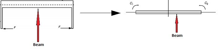

This is unfortunately quite sloppy since the beam is deformed - I have lots of overlap and it's difficult to clean up for meshing. I am currently just reducing repair tolerance and using virtual operations to clean it up but I'm not sure exactly which virtual operations are needed. Typical error messages when trying to mesh this are "overlapping faces" and "failed to insert point".
If anyone has any ideas on how to do induce the moments C_1 and C_2 more gracefully or implement the arms without overlap or any tips on which virtual operations could best be employed here, I would be extremely grateful. Thank you very much!
Have you considered applying a spatially-dependent load on each end of your beam?
A load that's positive at the top, same magnitude but negative at the bottom, and varies linearly in between will apply a torque without applying a net force. From a Saint-Venant's principle perspective it is the same as a concentrated torque.

I did not consider this, it sounds great! Do you mean applying the loads on the the upper and lower edges of the beam in the longitudinal direction?
Also, what sort of boundary conditions could I use for this? In some cases this beam will be deformed asymmetrically and I will want to apply moments/torques asymmetrically. The advantage of using the arms was that I could apply my constraints mostly to them without having to place any non-physical constraints on the beam. Right now the only constraint on the beam is an x,y-fixed-point on the bottom-center so it is free to move vertically which will be necessary in the asymmetric cases. I can't find a way to hold the beam in three dimensions without interfering with this asymmetric bending somehow.

Note that imposing no displacement at a single point is not enough constraints to remove all three rigid body motions in 2D: the rotation around the fixed point remains unchecked. Ultimately, how you constrain the structure needs to be decided based on the physical reality you're modeling.
