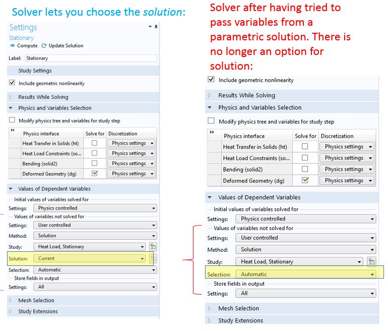

For anyone that may be interested; I tried to go back and run the studies again without a parametric sweep in the first step - this always works for me. This time however, the deformed geometry solver seemed to be permanently changed from my earlier attempt at passing the variables from the parametric sweep. The solver seemed to still want me to make a selection from the referenced solution although the option to choose a solution was gone. In this way, the study did not work to pass the variables.
This probably isn't a problem for most but I just wanted to point it out. Also, it's possible that that there is a solution to this but I couldn't recover that study step. In this case you have to delete and remake the study step or revert to a previous model. I attached a picture to show the difference between the deformed geometry solvers before and after trying to pass variables from a parametric sweep. Thanks for reading.
