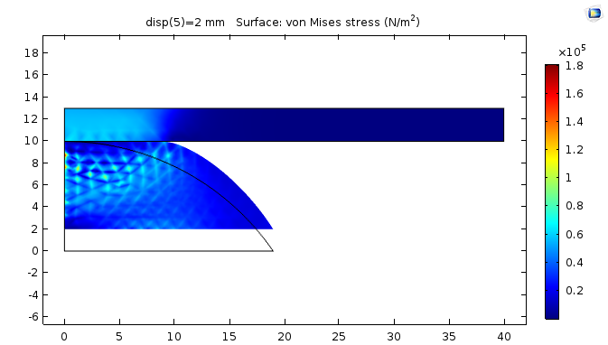

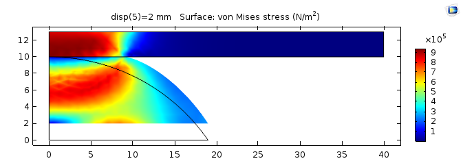

I'm trying to model the pressure distribution of an experiment I conducted where a fixed silicone rubber hemisphere was pressed against a glass plate by moving the platform the plate was mounted on into the hemisphere using fixed distances (0.5 -> 2 mm). This was conducted to determine the surface area of contact for specific forces.
Because the silicone hemisphere was moulded in the lab (and assuming it isn't hyperelastic), I need a way to find the appropriate values for the hemisphere's Young's modulus and Poisson's ratio. However, this has been more difficult (to guess) than I thought it would be.

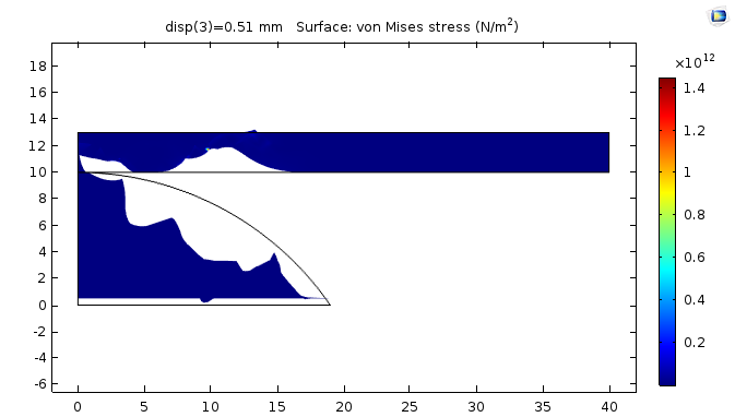

At 2 mm of compression, the resulting force was about 8.5 N. However, using the model I have with [Young's mod = 0.008 GPa, Poisson's ratio = 0.47], a total force of 220.7 N is calculated. By increasing the Young's modulus, this total force decreases but the model struggles to solve. Increasing the Poisson's ratio allows the model to solve at higher Young's mod values but the solutions don't always seem correct. e.g. with [Young's mod = 0.0005 GPa, Poisson's ratio = 0.4999] the total force = -18.718 N.
(the surface plots for the von mises stress of each of these examples are attached)
Therefore the help I need is in finding appropriate Young's mod and Poisson's ratio values for the model resulting in an 8.5 N total force for a 2 mm displacement.

As for using the nearly incompressible material option, this causes even less convergence and stranger solutions such as the one attached

I think you're right about the ill-conditioning. When I changed the glass to acrylic, my model solved without any problems. I've tried changing the mesh size previously but it hasn't helped much. I just tried solving the model with an extremely fine mesh and very tight tolerance in the stationary solver but I'm still having this problem with glass. Is there anything else I can try to help my model converge correctly?

If we go with the hypothesis that the discrepancy between your experimental data and model results as well as your difficulty in getting the model to converge at all in some cases are coming from the large difference in Young's moduli between the two materials, then a logical thing to try would be to artificially decrease the Young's modulus of glass in your model. As long as it remains, say, a couple of orders of magnitude larger than that of the spherical cap, that won't affect the solution significantly but it would make a big difference in terms of the suspected ill-conditioning.
