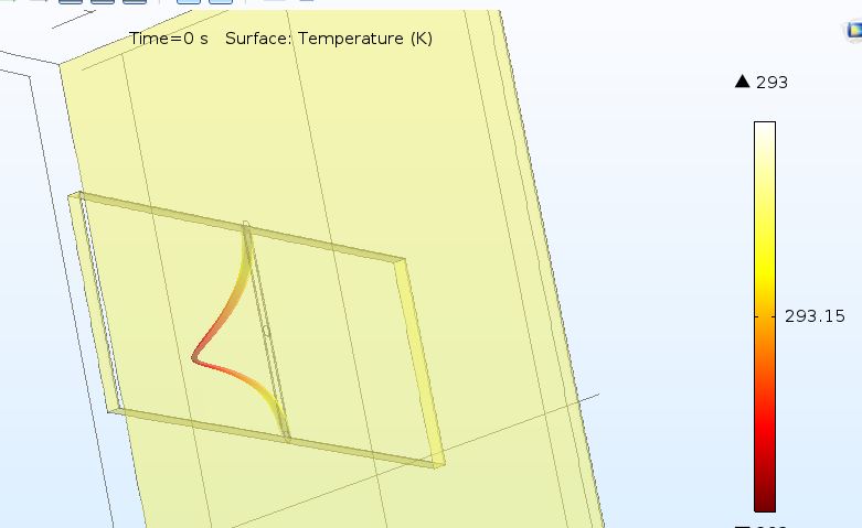

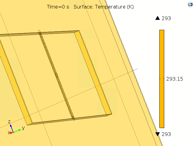

Hi, i'm trying to simulate a micro bridge heated by laser. The bridge seems to be moving but when i when i'm viewing the temperature differences, all the bridge seems to be at the same temperature...
The colors show a temperature difference but the values shows the same temperature..
I dont think its a range thing..

Alexandra,
Seems that you don't have appropriate temperature coupling - make sure you selected heat source domain and correctly defined heat source, or upload your model to get more specific answer to your question.
Sergei
Alexandra, Seems that you don't have appropriate temperature coupling - make sure you selected heat source domain and correctly defined heat source, or upload your model to get more specific answer to your question. Regards, Sergei
