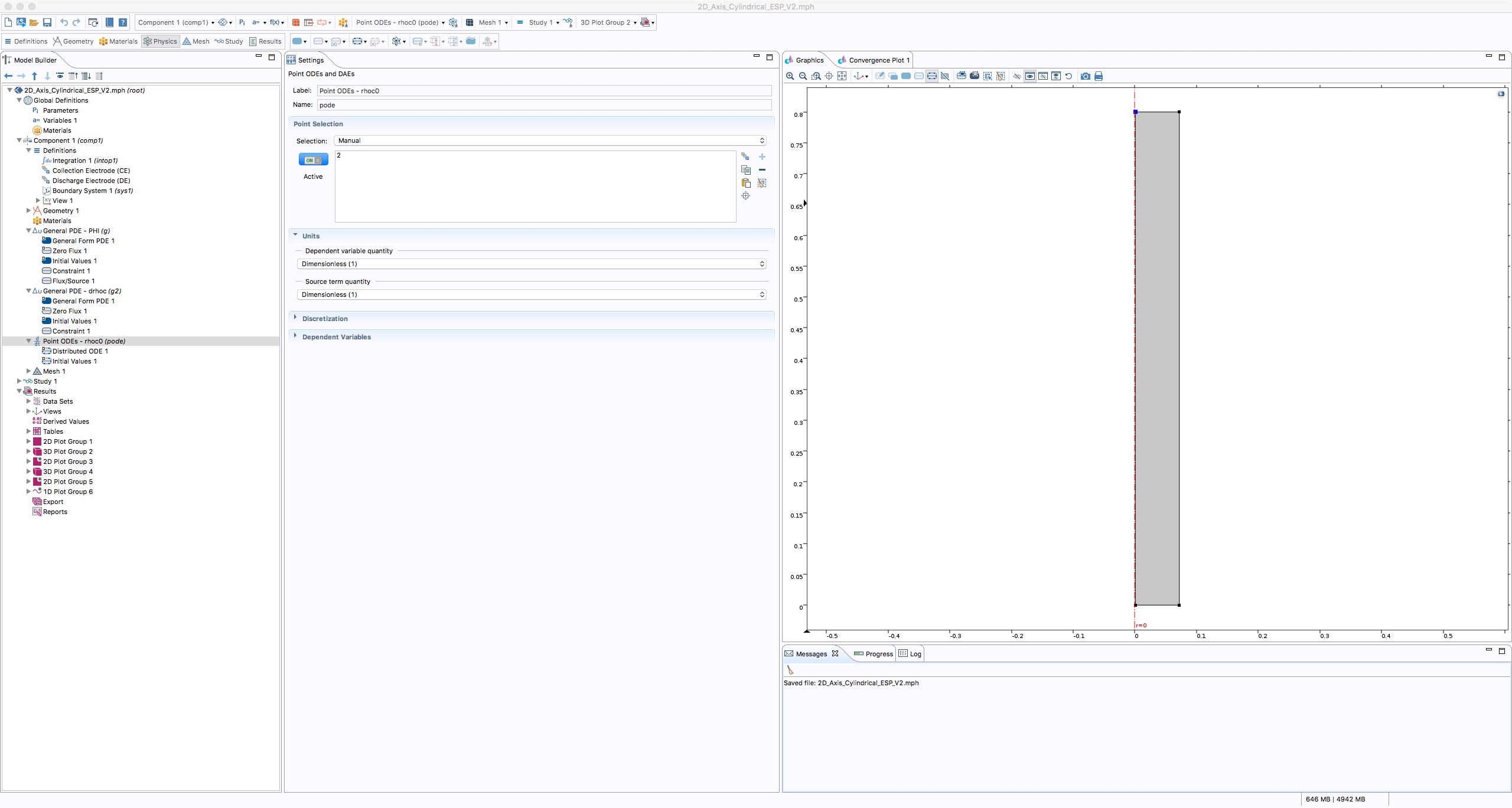

Eric Aerosol Control Technology
Posted: 8 years ago Dec 1, 2016, 4:15 p.m. EST
Eric,
Thanks for the suggestion. I have the issue resolved. The electric potential at the collection electrode needs to be a Dirichlet BC to make it well-posed. The variable BC can be applied with the point ODE.
I have another question about the integral constrain using the point ODE. I am solving a 2D Axisymmetric ESP (see attachment). Instead of using a fixed point to constrain the electric potential to V0 at the discharge electrode, is it possible to move the point ODE along the z-axis during each iteration step to obtain a 2D distribution of the electric potential?
Thanks again.
Eric, Thanks for the suggestion. I have the issue resolved. The electric potential at the collection electrode needs to be a Dirichlet BC to make it well-posed. The variable BC can be applied with the point ODE. I have another question about the integral constrain using the point ODE. I am solving a 2D Axisymmetric ESP (see attachment). Instead of using a fixed point to constrain the electric potential to V0 at the discharge electrode, is it possible to move the point ODE along the z-axis during each iteration step to obtain a 2D distribution of the electric potential? Thanks again.

Posted: 8 years ago Dec 2, 2016, 12:12 p.m. EST
Hello Eric,
What is possible is to have a fixed potential at the electrode together with a non constant charge density over the electrode. I don't think the location of the point matters. I might not fully understand your request though. We can help you regarding these questions through the technical support. I encourage you to contact support@comsol.com regarding this.
Best regards,
Eric Favre
COMSOL France
Hello Eric, What is possible is to have a fixed potential at the electrode together with a non constant charge density over the electrode. I don't think the location of the point matters. I might not fully understand your request though. We can help you regarding these questions through the technical support. I encourage you to contact support@comsol.com regarding this. Best regards, Eric Favre COMSOL France
