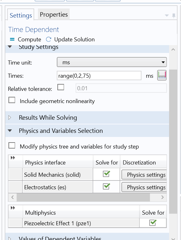

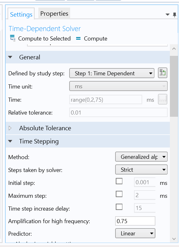

the 2 ms timestep is not sufficient for your waveform. You should use some ten steps per period. You also didn't check the checkboxes in the time stepping.
If you excite with a continuous harmonic wave and all is linear in your model you can use the frequency domain solver which is much more effective in that case.
Cheers Edgar

Thank you Edgar, I would like to see the actuator response based on geometric nonlinearity hence I only used freq-domain to perform a check on the eigen-mode analysis.
I tried changing the time-step to 0.1 ms (75 steps per period) but I see the same output. Looking at this response, it seems like there is a numerical integration issue (I tried different solvers to no avail)? Do you suppose it will help if I somehow stored the previous solution (I don't know if there is an option to do that somewhere or if it is doing that already). Another option would be to run stationary solver, store that value as the initial value and use it to perform time-domain study.
How can I resolve this issue?
Thank you again for your help.

Ok, so I resolved this issue.
I took the following steps:
1) changed the time-step and made is very small (e.g. 100 steps per period)
2) plotted Z-displacement and not the total displacement (assuming the actuation will happen in z-dir).
3) included step1: stationary. step2: time dependent.
4) clicked on step2: entered range(0,0.05,37.5) ms. For my simulation, this creates 5 periods with small step size.
5) In step2, I made sure that the time-step is restricted. (Solver Configurations->Time-Dependent Solver1: panel on right, expand TimeStepping->Initial step=0.001ms, Max Step=0.05ms, which matched
with my step size.
I got a very nice sinusoidal displacement.
Hope this helps someone else (sorry comsol forum wouldn't let me post my files for some reason).
Thank you.

Sorry I forgot to mention step 6.
6) Went back to Step2: time dependent panel (main panel) and set up the following:
Values of Dependent Variables->Intial values of variables solved for->Settings: User Controlled, Method: Solution, Study: <Study name>, Stationary
Values of variables not solved for->Settings: Physical Controlled.
I didn't change anything in the stationary.
