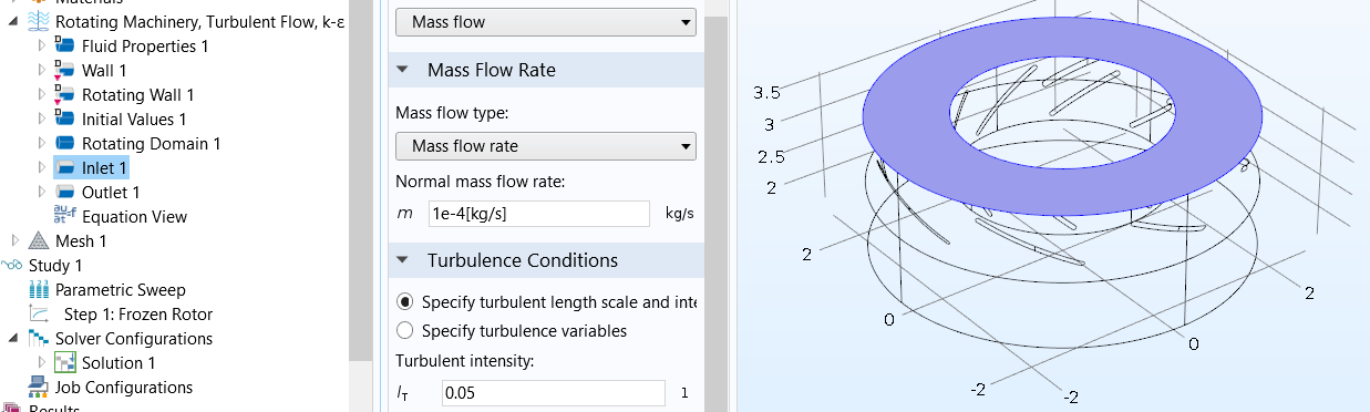

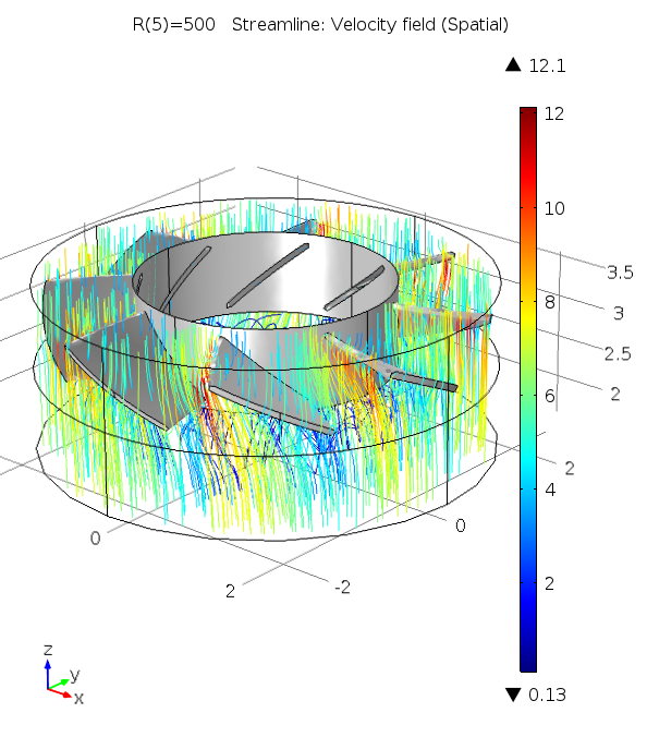

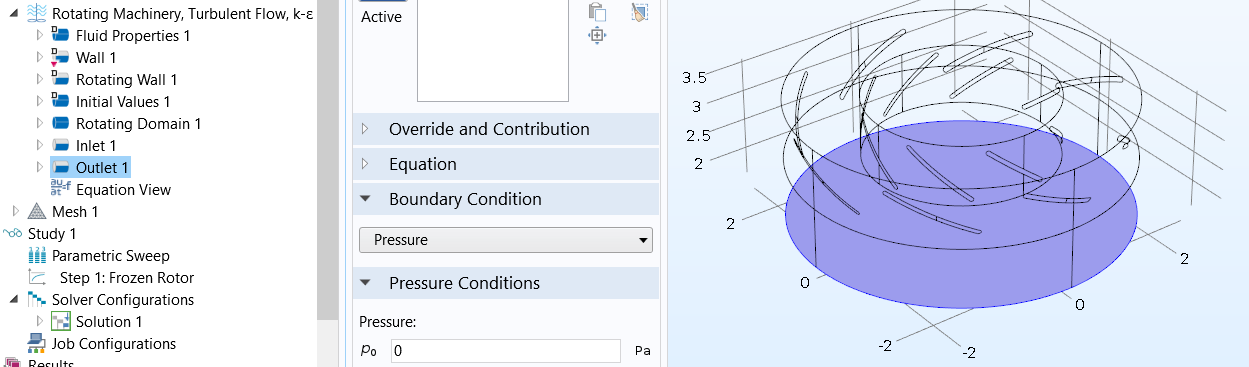

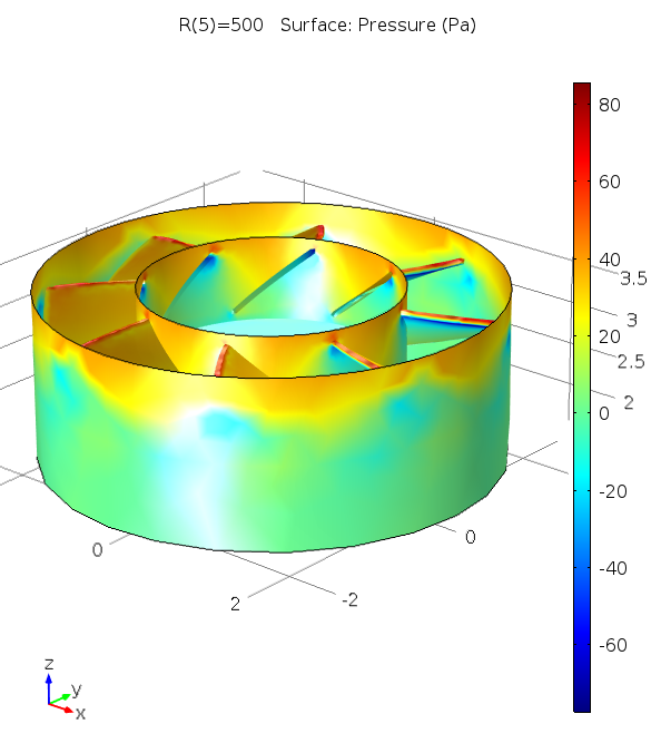

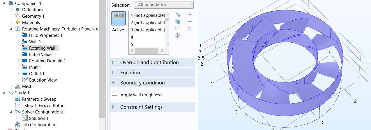

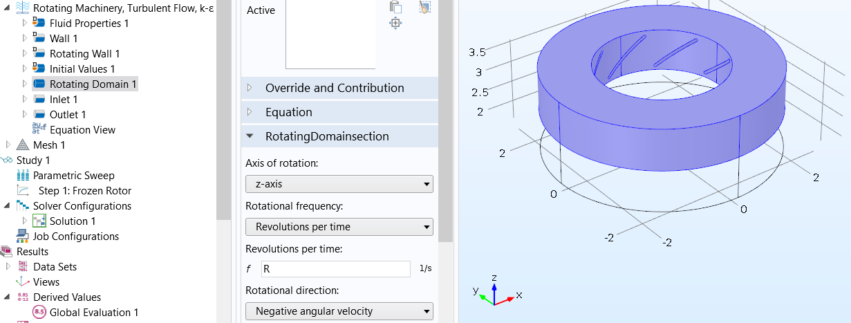

I was trying to simulate a axial fan model in rotating machinery module of COMSOL 5.2 to predict the fan efficiency, CFM values. Though I simulated the physics by extracting the fluid domain from the solid fan model and providing rotation(500 / s) for rotating domain, input mass flow rate and outlet pressure; I could n't able to calculate the CFM and fan efficiency values in COMSOL. I have attached some photos from the model. Please help me to simulate cfd of axial fan and predict CFM and fan efficiency in COMSOL 5.2.
