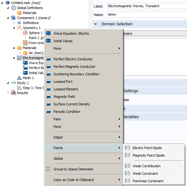

I don't quite understand your point, because I am simulating a quantum emitter as a point dipole. For example, I have air as the background medium and place two points that will be my electric dipoles. I want to put one of them oscillating and the other static. The field of the first one should be able to excite the other and put it oscillating with the same frequency, but I don't know how to do that. I thought about time domain but I am not able to define a point as a dipole.

Point dipoles are available in time domain, as shown in the attached image.
Sergei
