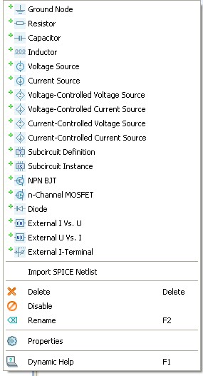

Here is a screen shot of what you can do with COMSOL "spice". See attached picture.
Not everything that you can do in LTSpice, Orcad, etc, can be done in COMSOL. It is fairly limited and primitive.

you should be able to use "arbitrary behavioral" elements. these are the dependent sources that are listed in the image i attached above. things like a voltage controlled voltage source and so on. in spice lingo these are E, F,G,H elements. if may not be a pretty spice model but you can do it.
