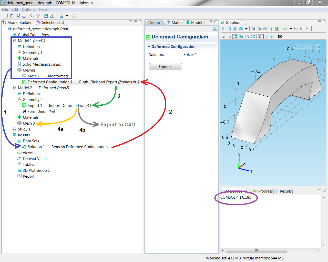

Hi Austin
Have a look at the attached picture on how to remesh a deformed geometry and export to CAD or reuse it in a new model. This was done with version 4.1.
Best regards,
Zoran
Hi Austin
Best regards,
Zoran

Thank you Zoran, very useful, I've been trying to find out how to do this for ages.
Richard

Posted:
1 decade ago
Aug 31, 2011, 6:17 a.m. EDT
hallo,
I was trying to export the deformed configuration as CAD model (deformed structural mechanics under load, 3D) using your scheme in the 4.1 version, as I just have the 4.0 version, I don 't have deformed Configuration plug in.
please, do you know how to do this with 4.0?
Thanks in advance for your help,
looking forward to hear you soon,
Best,
Hamid

Posted:
1 decade ago
Dec 2, 2011, 9:14 a.m. EST
Hello Zoran,
I also followed the workflow to remesh a deformed geometry as you indicated on your nice outline. It all worked well in version 4.1. But now I'm using 4.2a (4.2.1.134), and just repeating the same steps, I don't get the deformed geometry but a copy of the original geometry. Maybe this is a bug in this latest release?
Hello Zoran,
Posted:
1 decade ago
Nov 8, 2012, 1:51 p.m. EST
I agree that this same thing is occurring in 4.3a -- e.g., the imported mesh is not the deformed mesh. Does anyone have an update as to how this should actually work in the newer versions? The workflow seems logical, and it would be nice to see it work OK.
John
John
Posted:
1 decade ago
Mar 23, 2013, 5:20 p.m. EDT
Hello Zoran,
I am also having the same issue with COMSOL 4.3. When I make the deformed mesh, it is the original geometry, not the deformed geometry. Any updates on this?
Thank you in advanced,
Adan
Hello Zoran,
Adan
Ivar KJELBERG
Posted:
1 decade ago
Mar 24, 2013, 2:40 p.m. EDT
it could be that you need to turn on the solver "non-linear" geometries in the later versions, it's just a guess from my part as I'm not by my WS so I cannot check, but there was a change in the later versions on the way the spatial and material frame was handled (and from where)
