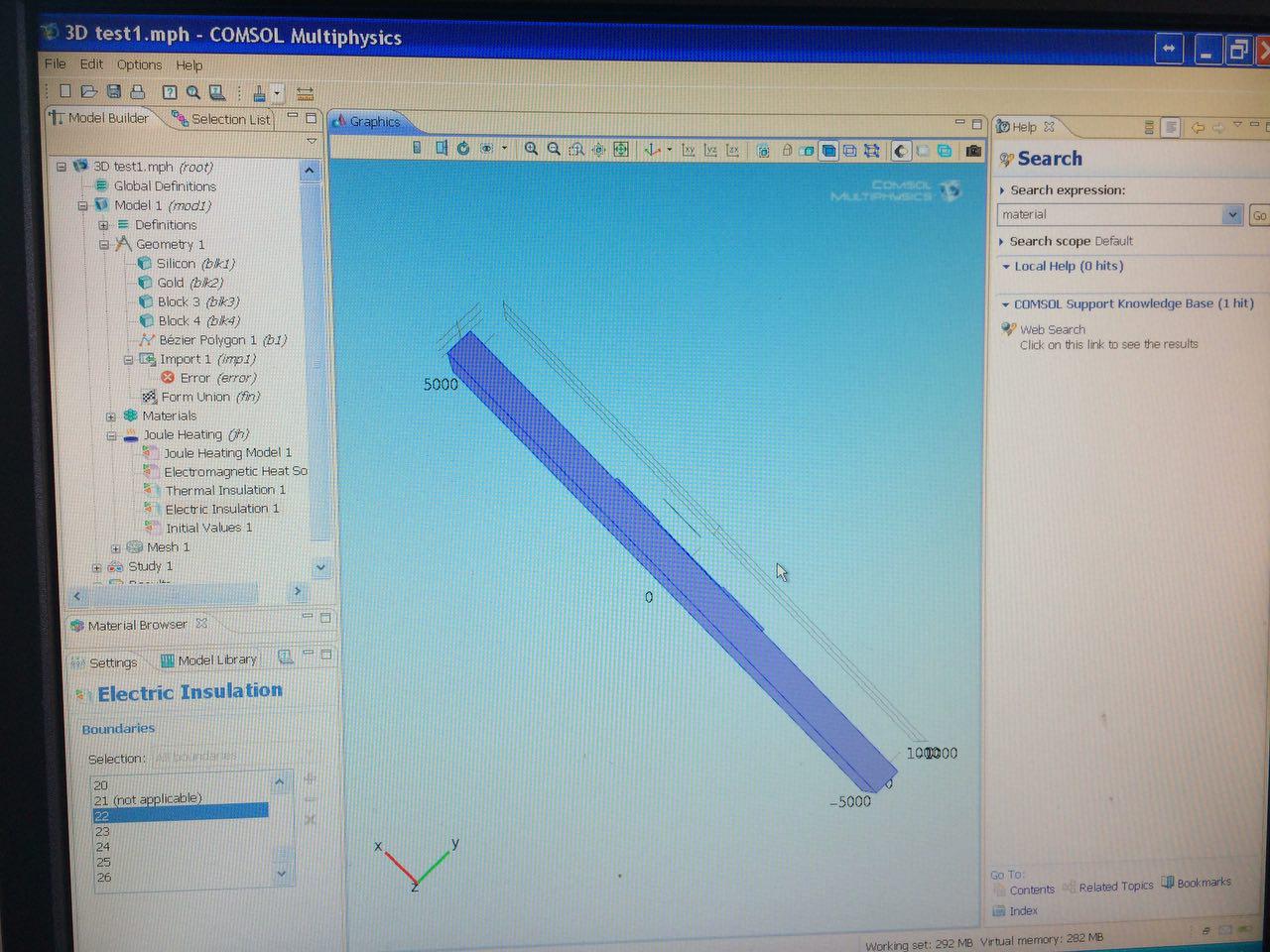

Yes, sure. It is attached.
Boundaries are shown in the left bottom corner but I can't define them.

That's not version 3.5a. It's some flavor of version 4.
The GUI changed thoroughly at version 4.0, so you won't be able to follow instructions written for 3.5a with this 4.x installation.
Best,
