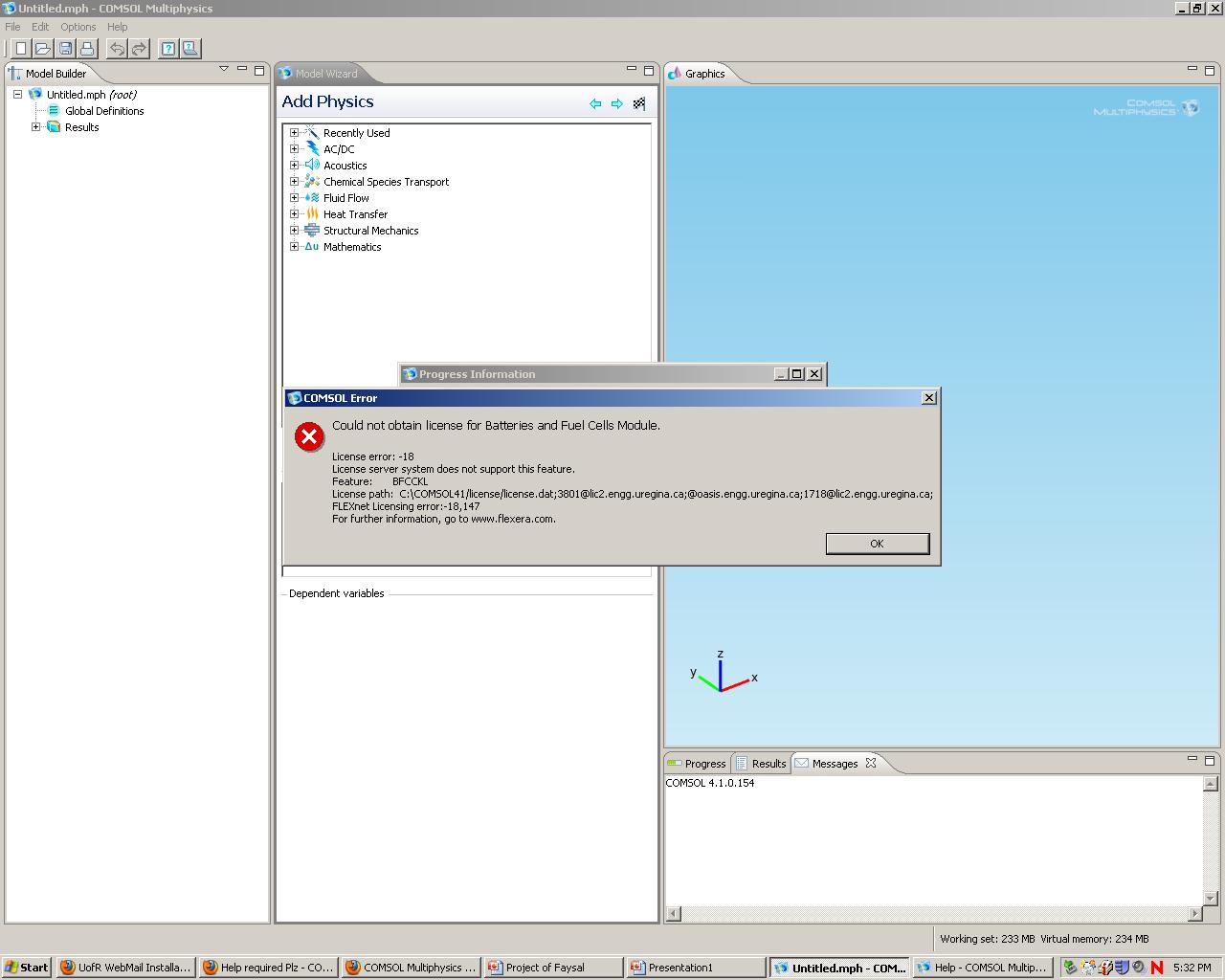

I am very sorry to let you know that i can not open your file cause i do not have the license for Batteries and Fuel cell mode ........

You do not need batteries and fuel cell physics for this. I can see that your model is packed bed and it is a reforming of C2H6O which is endothermic reaction, i.e. there must be a pressure drop and you can maintain isothermal condition by implementing external heat source.

Please check the JPEG picture. This is what i am having trouble opening your model in my PC.

I don't know whats the problem is, I have used the physics under chemical engineering, fluid flow and heat transfer...so there must be something else! may be you should contact the support related to this.
