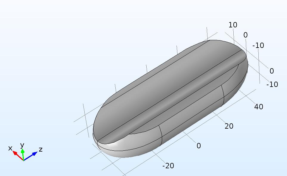

I am new to Comsol, and I am now dealing with the stimulation of the Scattering/Absorption/Extinction cross-section of a Gold Nanorod concave structure(Fig.1). My work is based on the APPs: Scattering nanosphere & scatterer on substract.

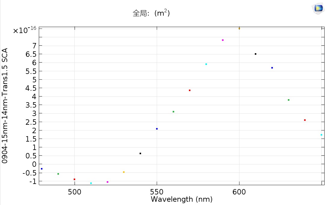

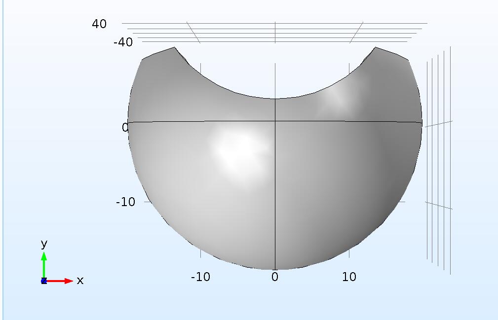

nx*x+ny*y+nz*z>0 for some parts of the concave inner surface, while the others <0. (Fig.2)
3. While I define ofact=if(nx*x+ny*y+nz*z>=0,1,-1), the scattering value sometimes be negative, does a negative value of scattering corss-section meaningful? (Fig.3)
