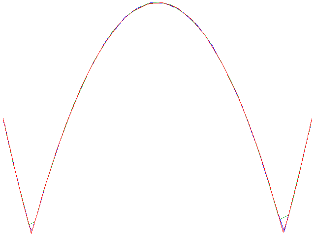

velocity profile
greeting
I'm using the slip velocity for the wall condition and I got the following velocity profile
can any one explain why this decrease in velocity near the wall, please.

Posted: 8 years ago Sep 13, 2017, 12:19 p.m. EDT
Saja:
spf.U is a resultant speed variable. Change the variable you are plotting to 'v' (y-axis velocity component) and there should be no negative speed.
Sri,
Saja: spf.U is a resultant speed variable. Change the variable you are plotting to 'v' (y-axis velocity component) and there should be no negative speed. Sri,
