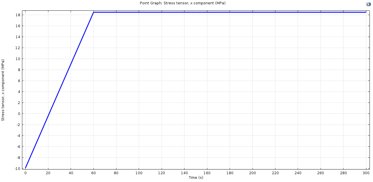

How do I get a Time dependent load in COMSOL?
I tried using a step function but it gives me a very sharp transition zone as shown in my image.
My main problems are:
  1. Obtaining a constant load for t seconds (e.g -10 MPa for time 0<=t<=40 sec)
  2. After 40 sec my stress profile should be rising steadily to a maximum where it stays constant again.
  3. My transition zone is too sharp.
Thank you for your support

I suggest that you use a Ramp function or possibly a Step function with a large smoothing zone.
