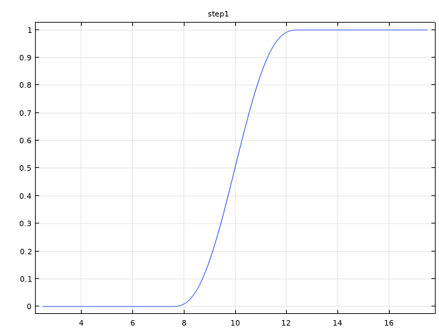

It will start whenever the input value (the time, for example) reaches the value of the step location, so it is not relative but an absolute value of the step's input, whatever that is. It is often set to a small positive value to delay the step a little bit at the start of a transient simulation. You can find all models and apps that use a Step function node by searching for @step in the Search field in the Application Libraries window. In the attached plot of a smoothed step function, the location is set to 10.

Hi, It will start whenever the input value (the time, for example) reaches the value of the step location, so it is not relative but an absolute value of the step's input, whatever that is. It is often set to a small positive value to delay the step a little bit at the start of a transient simulation. You can find all models and apps that use a Step function node by searching for `@step` in the **Search** field in the **Application Libraries** window. In the attached plot of a smoothed step function, the location is set to 10. I hope this helps. Best regards, Magnus Ringh, COMSOL
