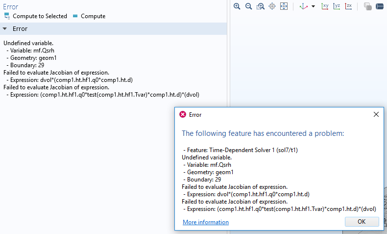

I did check the material definitions and everything seems to be fine. Inorder to check the source of error, i tried to run simulation without magnetic field study (performed only thermal study with some assumptions on heat sources) then thermal study runs fine . I feel the problem exist only when both magnetic field study is combined with thermal study and heat flux is unable to read the term mf.Qsrh. I have done similar kind of study earlier but never found such errors , not sure if this source of error comes from design aspect.
I am attaching the screenshot of error which i get whenever i tried to compute thermal study. The boundaries which are showing errors are ones where heat flux is being assigned (with inputs from magnetic field study mf.Qsrh).
Hi, I did check the material definitions and everything seems to be fine. Inorder to check the source of error, i tried to run simulation without magnetic field study (performed only thermal study with some assumptions on heat sources) then thermal study runs fine . I feel the problem exist only when both magnetic field study is combined with thermal study and heat flux is unable to read the term mf.Qsrh. I have done similar kind of study earlier but never found such errors , not sure if this source of error comes from design aspect. I am attaching the screenshot of error which i get whenever i tried to compute thermal study. The boundaries which are showing errors are ones where heat flux is being assigned (with inputs from magnetic field study mf.Qsrh).

What study are you using ? COMSOL might not be able to evaluate mf.Qsrh in a stationnary study (usually used for heat transfer model, so I am assuming you used that). You may need to do a frequency analysis of the mf study and then, in a second step, a stationnary one.
Hope it works !
Hello, What study are you using ? COMSOL might not be able to evaluate mf.Qsrh in a stationnary study (usually used for heat transfer model, so I am assuming you used that). You may need to do a frequency analysis of the mf study and then, in a second step, a stationnary one. Hope it works !
Posted: 6 years ago Jun 11, 2018, 8:48 a.m. EDT
Also, I don't think mf.Qsrh is a Heat Flux. q is the heat flux of a model but Q usually refers to a Heat Source. Therefore, when setting up your physics, do not use the "Heat Flux" boundary condition but the "Boundary Heat Source" condition. (By right clicking on the physic node).
